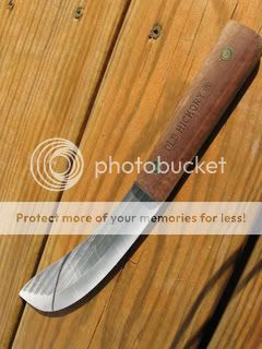

I thought I'd share some pics of a little project I did this week. I took an Old Hickory skinner and made a Nessmuk style blade out of it. (I see now that others have done this as well) I took photos so I'll go ahead and share. The OH knives come real rough, but with some elbow grease they clean up nice.

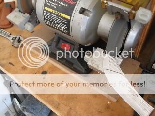

First I marked out the general shape.
Then I went to the grinder. I used a bucket of ice water to keep things cool.

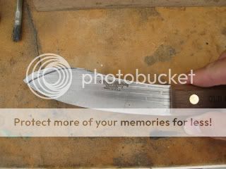

I got close to the shape I wanted on the grinder, but next its off to the 1 x 30 belt sander to finish.
Belt sander got me to the desired shape.

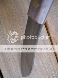

And cleaned up/smoothed out the spine and handle.

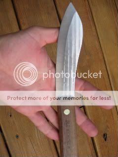

Finished product with an edge on it. What do you think?

Hey, it looks great! Good eye for proportion and rounding the spine
