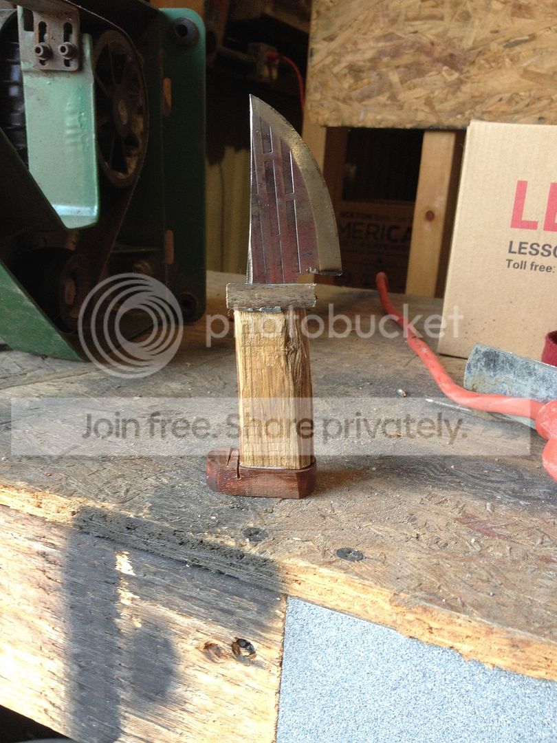

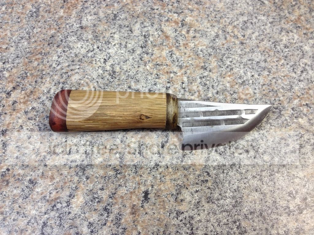

Just thought I'd update here a little. I saved the tip I cut off my original project and have made a small skinner I'm going to give my bro-in-law for his birthday. It's not quite finished but it's pretty close
Here it is glued up and ready to shape
And here it is sanded down and just about ready for some tru-oil
I'm think it's just basic old school 1095. I'm going to attempt a retreat at some point just to see what happens
