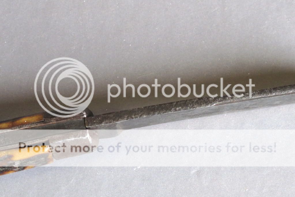

I don't know why they used open dovetails. It's an interesting question. Maybe one of our knife-making friends has an idea!!??
That is a beautiful Jack, and a quintessential NYK, Vince, but IMO, it is a Regular Jack, as opposed to a Swell end. A Regular jack has straight sides, while a Swell end, which is also called a Teardrop, is more pear-shaped; the sides curve in slightly.
I am paraphrasing Bernie Levine, whose naming system is largely based on history, and was a result of years of study. I think it's the best so far. Here's a pair of Swell ends/Teardrops!
navihawk was right...mostly. The open dovetails made it easier for the folks with the task of hafting to put the handle material on. That's easier than fiddling with putting handle material inside 90degree ended covers(meant "bolsters"). Closed dovetails weren't used because they captivate the handle material and potentially create a problem in the knife due to swelling. No room to expand will create pinches in the pivot(s).
navihawk was right...mostly. The open dovetails made it easier for the folks with the task of hafting to put the handle material on. That's easier than fiddling with putting handle material inside 90degree ended covers. Closed dovetails weren't used because they captivate the handle material and potentially create a problem in the knife due to swelling. No room to expand will create pinches in the pivot(s).
Also, "open dovetails" helped hide any movement in the various natural scale materials -- both visually (due to the overlap) and by touch (because a little shrinkage wouldn't expose any sharp bolster edges, since there were none).
Right...that too.:thumbup:;) Now go and look through your old knives and see how many have very slight open dovetails. Tony has showed me several of his old knives that have them.

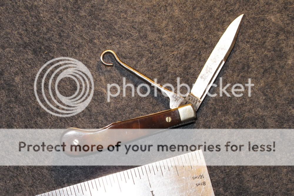

While maybe not as impressive as a large knife. I find this fascinating for the delicate work that went into it. Especially for the tiny screws.
I believe this is real tortoise, both because of the age of the knife and that it's not as colorful as the imitations.

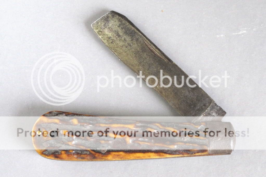

Here's another regular jack (Thank's Charlie :thumbup:), but hafted in bone and 3 1/4" closed. Nickel silver bolsters and shield on this one and only two scale pins per side on the smaller bone hafts. Carried, sharpened and used, this one still retails a partial blade etch along with a partial fingerprint etch as well. Shown along with the 3 1/2" rosewood knife to see the subtle differences that only 1/4" in length makes on the overall knife size
And the two together
