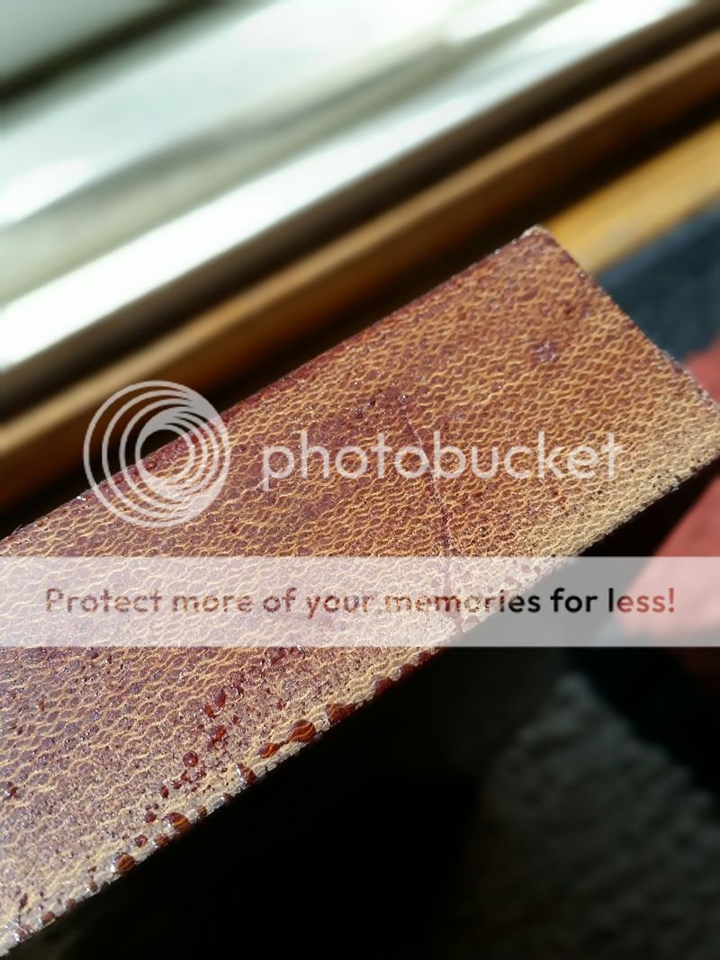

I've read articles stating that the linen and canvas (especially canvas) were used in many industrial applications. Micarta was first developed as early as 1910-1911. Other than electrical panels/circuit boards, Micarta has been used in gaskets, gears, pulleys, even early car parts. I remember seeing an auction site posting that had Micarta parts for a Model T.
The paper and Ivorite micartas were developed for more decorative applications.

This piece features two black lines and a two tone surface-- one being black speckled and the other an aged yellowish ivorite.

Westinghouse invented the material. A lot of their original recipes and methods of pressing batches weren't and couldn't be replicated today.
Authentic Westinghouse Micarta can be identified by a few traits like single or double colored lines, some can identify it right away by a unique smell.
