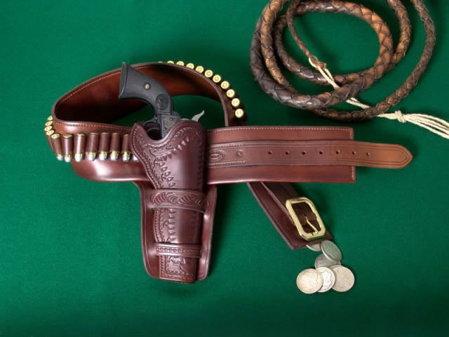

I use black walnut hulls (If they are not available locally - the fresh green hulls are best - you can buy them dried on line from various vendors - to find a vendor search for walnut dye, etc.) Put a pound or so of the crushed hulls in an old stocking and place in a pan of distilled water so that the water covers the walnut hulls about an inch. Cover it and simmer at a low boil for several hours and then let cool overnight - keep an eye on the water level. The next day boil again and let cool overnight. Again watch that the water level does not get too low, but you do want it to get fairly thick. Once it's cool drain off the liquid be sure to squeeze all of the liquid out of the bundled walnut hulls. Save the walnut hulls - hang them up to dry and you can use them a couple of times more. The liquid will go bad so either keep it frozen or add 3/4 of a cup of rubbing alcohol to a quart of the dye. It will come out anywhere from a light brown/gray to a dark grayish brown before oiling (I use light olive oil a lot for oiling and then set it in the sun to darken) - the color will depend on the leather - every piece is different, how long you let it soak, and how strong the dye is. Reducing the liquid to the consistancy of syrup works well when some alcohol is added as a carrier.
This was done with the straight walnut dye. The darker parts are where the maker rubbed the hulls into the leather:

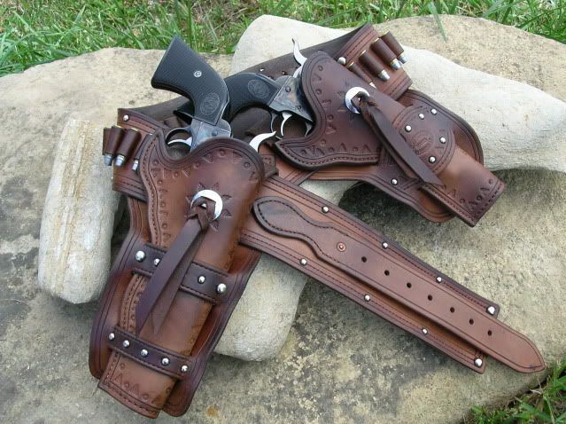

This one is the same walnut dye, but was allowed to hang in the sun while it dried giving it a reddish tone:
You can also mix the two by using a small amount of the vinegaroon ( a little goes a LONG way) into the walnut hull dye to give a rusty black as pictured below:
