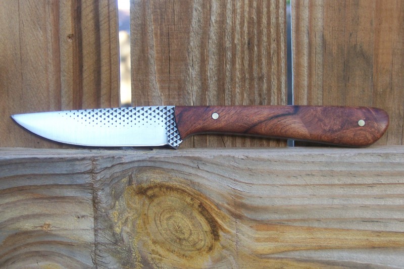

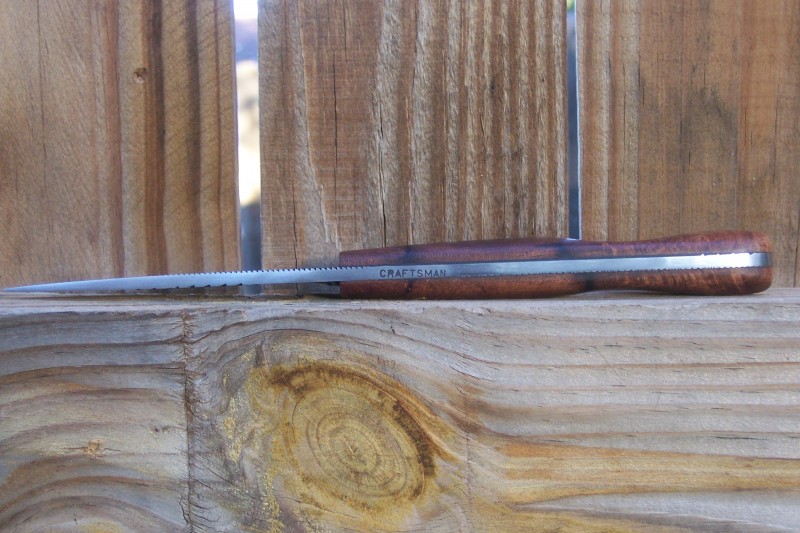

I have made two knives out of older craftsman rasps. Everyone's right, it's a bit of a crapshoot. The two I made worked out well. I'd personally trade a bit extra ferrite (from a low carbon file) or pearlite (from too slow a quench) resulting in a 57/58 hardness for the coolness of a file knife like this. The coolness of the pattern and Craftsman label, IMO, overcomes any metallurgical deficits. Pardon if the pic posting is against the rules, let me know and I'll drop them.
lots of people don't advise making knives from files, but if you use the teeth artistically I think it can be fantastic. ^ that one is a wonderful example of what I am talking about
