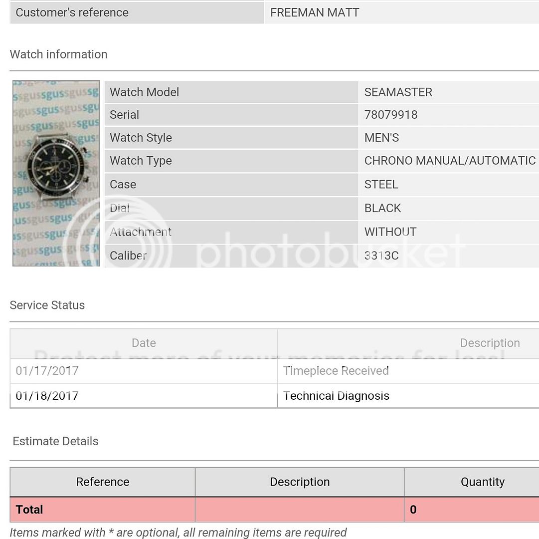

Got an email from Omega stating it has arrived.

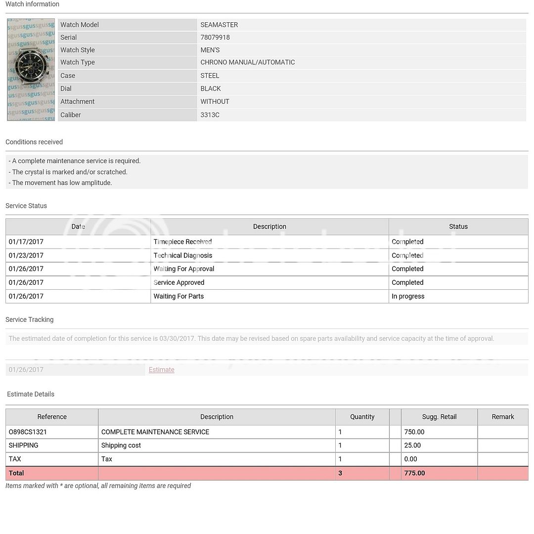

Why is that estimate so high and expensive? Have these watches really gone up so much since I looked at them to make a $775 service a reasonable expense? Or, was it pretty damaged and in need of significant repairs?
TIA,
Sid
Standard Omega chrono (with a coaxial movement) service cost. These can't be serviced by non - omega trained watchmakers.
Sent from my SM-G930V using Tapatalk
The estimate said "movement has low amplitude"...
Does that mean anything significant?
That's nothing. It means they need to clean out the old lube and then relube. Meant the ticking wasn't ticking hard bc of gummed up gears.
cchu518 is spot on.
Amplitude refers to the degrees of the beat of the movement. It's the swing of the balance wheel or the degrees of arc the balance wheel swings. Low amplitude is caused mostly by the lubricants becoming gummy so is corrected the vast majority of the time simply by cleaning and relubing the watch. The reason mechanical movements should be serviced every 5-7 years.
Could be the mainspring , but those are replaced very inexpensively. They may be replacing the mainspring; however, "waiting for parts" is a ridiculous reason for a manufacturers national service center for such parts.
$750 is a VERY hefty price to pay for inspecting, cleaning, and lubing a movement and replacing the mainspring even for a complicated movement like a chronograph. Do some research and find a competent local watchmaker in your area and build a relationship with him.

Do not follow that advice for THIS movement. The 3313C is not a movement for any watchmaker that isn't trained by Omega and doesn't possess the necessary specialized equipment. If you doubt this, ask on any Omega forum.

Find a competent watchmaker. He'll either accept the job or he won't. $750 every 5 years (and the cost will be more 5 years from now and more again the next service) is a ridiculous price to pay for simply servicing (cleaning and lubing) a chronograph. Even a coaxial.
Is a crystal replacement part of the service? It may explain the seemingly high cost of maintenance. On the bright side, at least you didn't send in something like a Glashutte or JLC Master Compressor. The service cost may have been something like $2k.
