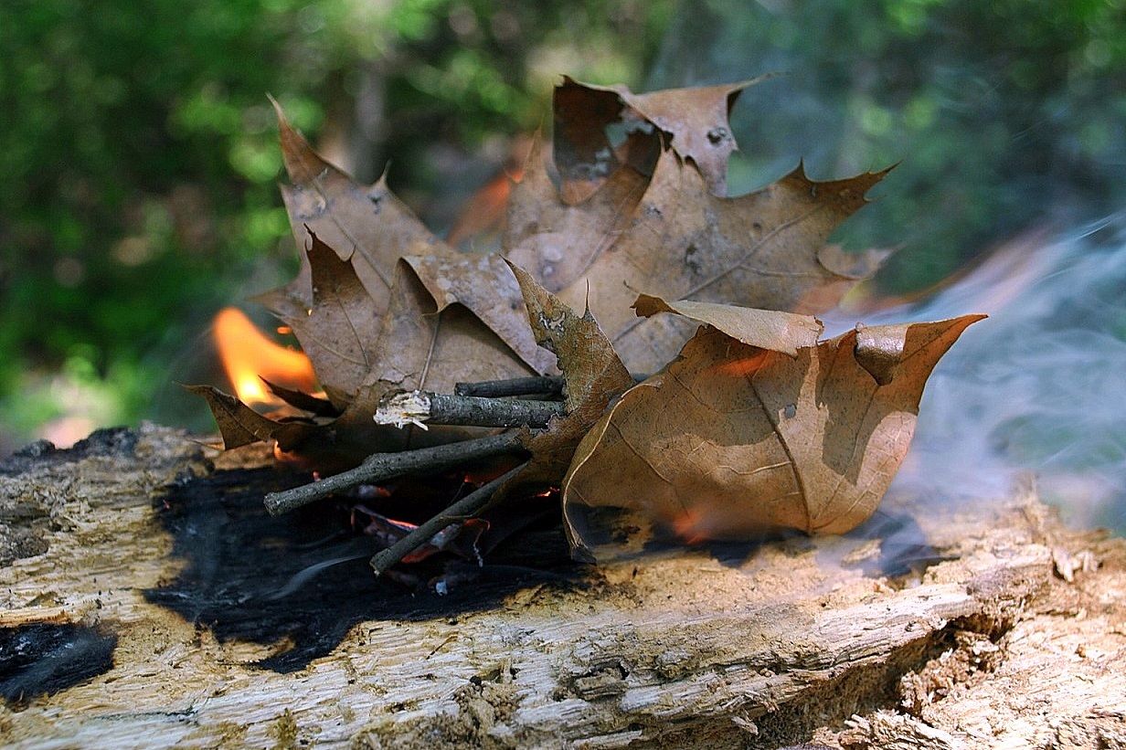

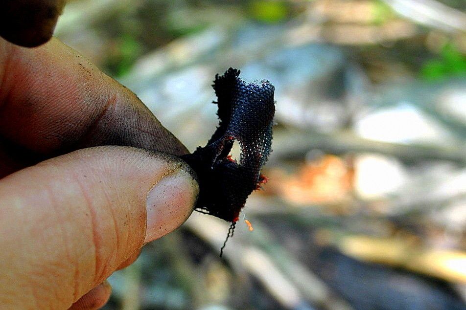

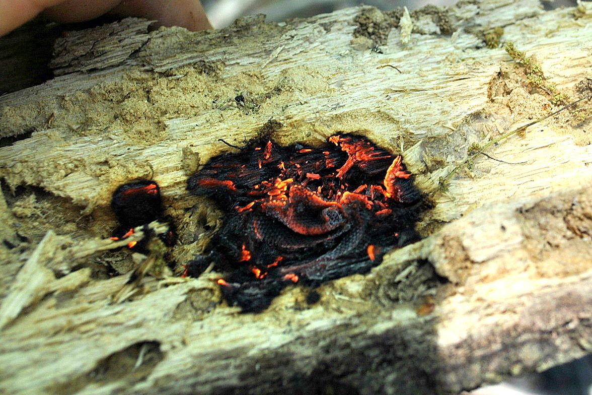

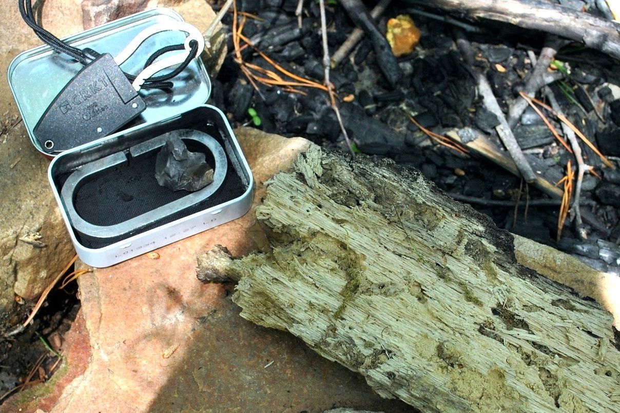

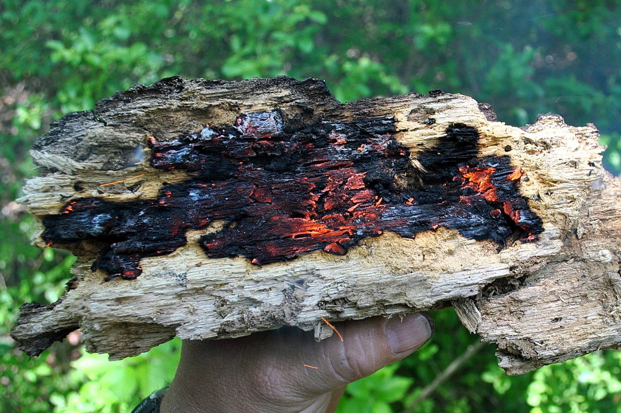

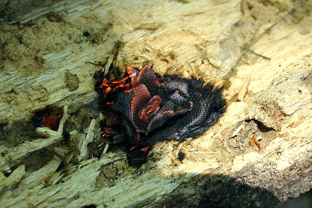

I used char cloth for my initial ember, and then the large chunk of dry punk wood to expand it and intensify the heat. I did this by making a divot in the punk wood and placing the embering char cloth into it, then blowing on the ember to expand it much like one would do with a tinder bundle with friction fire.
I have not used this technique to boil water yet, but it does get pretty intense. Blowing on the ember to give it oxygen and make it hotter, it easily got hot enough to ignite dry leaves.

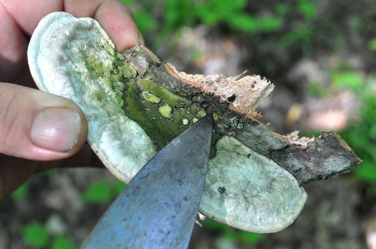

My main experience with use of polypore fungi is as a field expedient mosquito repellent. I read an article by Chris Janowski on the subject about twenty-five years ago, and have used it with success quite a bit since then. The porous interior has a lot of air flow when torn and it will smolder like an incense. So if you have several of them smoldering around your camp area the smoke wafting back and forth across the area help keep the mosquito nuisance down.

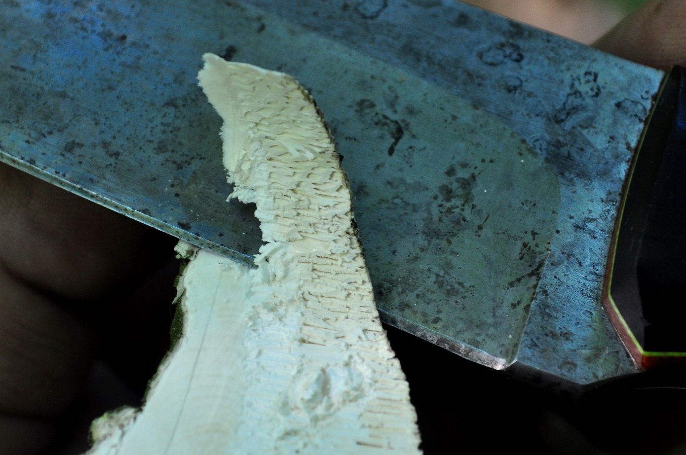

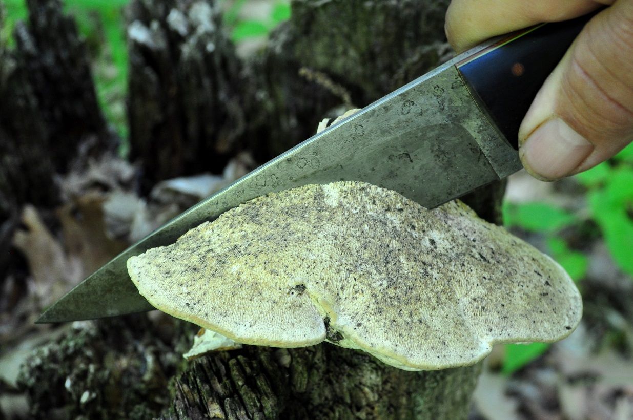

Since we do not have tinder fungus this far south, the uses of polypore fungus as a spark catcher and ember expander is a subject of great interest to me. I am told that when dry enough the fibrous edges of it when torn will catch the sparks from flint and steel and ember from there. So I have several experiments in this area planned for later this year in the drier season...right now we are in one of our wet seasons and about to go into the wettest one...
