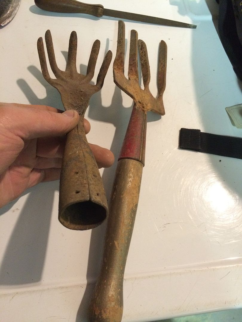

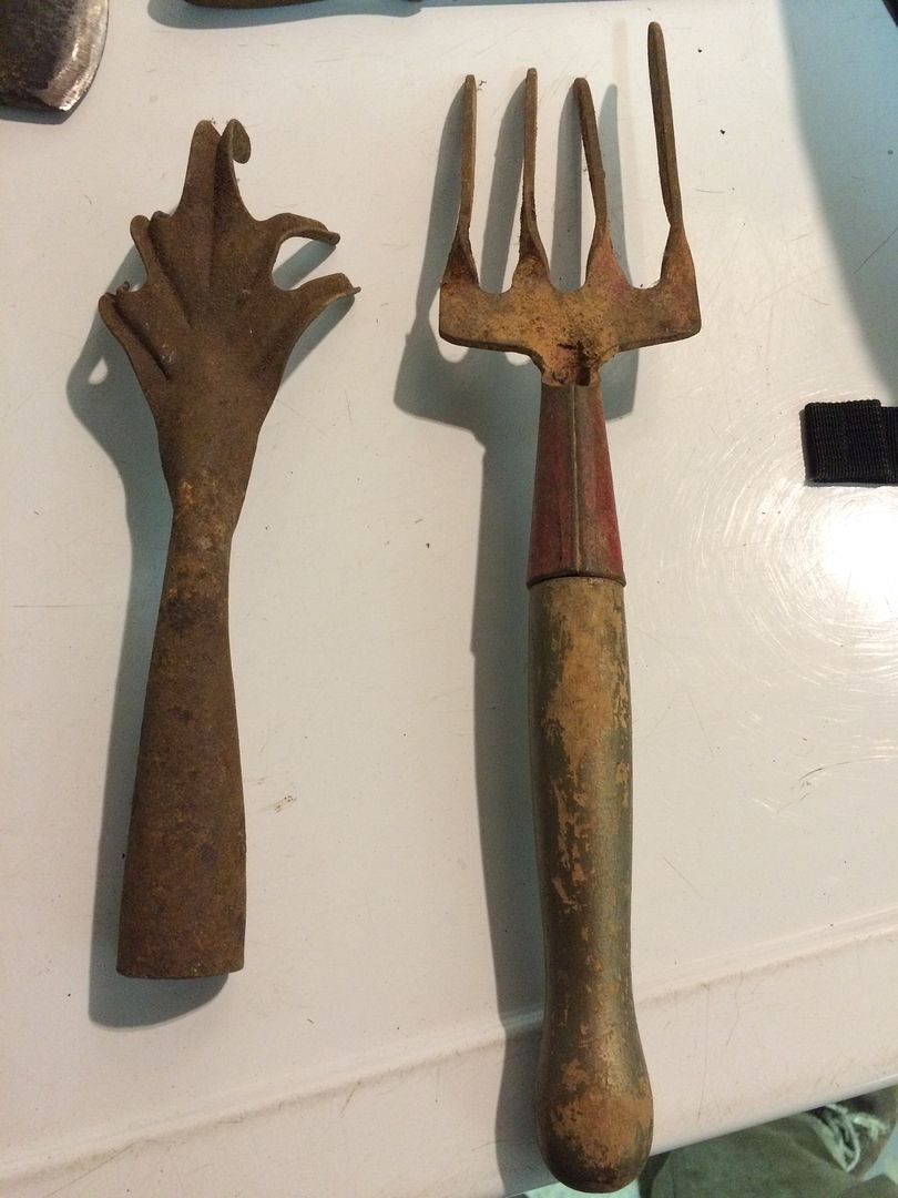

I know these things are used to loosen soil when gardening but what are they called and is it worth it to re-handle that one? Also, some of the forks/prongs are bent, should I use heat or try and cold-bend the metal straight? I don't believe they were stamped anywhere that I could see. Manufacturer? Would HH have a handle for these?

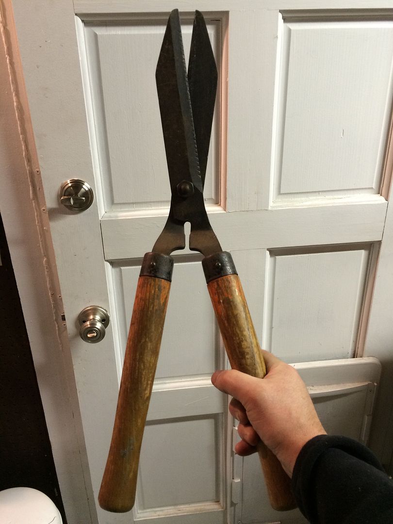

These hedge shears are stamped Seymour Smith & Sons. The handles are very loose, probably from me trying to chop anything and everything with them when I was a kid. Will HH have handles for them and/or what can I put on the handles to possibly try and save them? BLO? Do you just put BLO on pretty much everything? Related, I got a pair of Craftsman lopping shears that my brother and I also abused like crazy as kids. The new ones just aren't the same quality and the hickory handles are also slightly loose. If I pull the pins/nails and metal caps will the handles just slide out? I don't want to glue the handles back on but can I wedge anything in there to tighten handles like these back up?

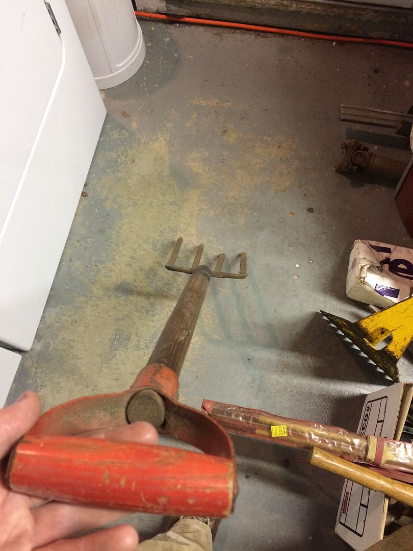

Says "American somethingorother made by True Temper" on the handle. No idea how old it was but I remember doing everything I could to try and break that stupid pitchfork as a kid... and now I want to straighten it. Do I apply heat before I try and bend it back? How much heat? I assume I can use BLO on the handle? (Yes that's a dryer in the background. I'm not allowed to wash my "work clothes" (play clothes to me) & shop rags in the house washer so I went out and bought my own $50 Craigslist washer & dryer so I can wash & dry anything I want!)

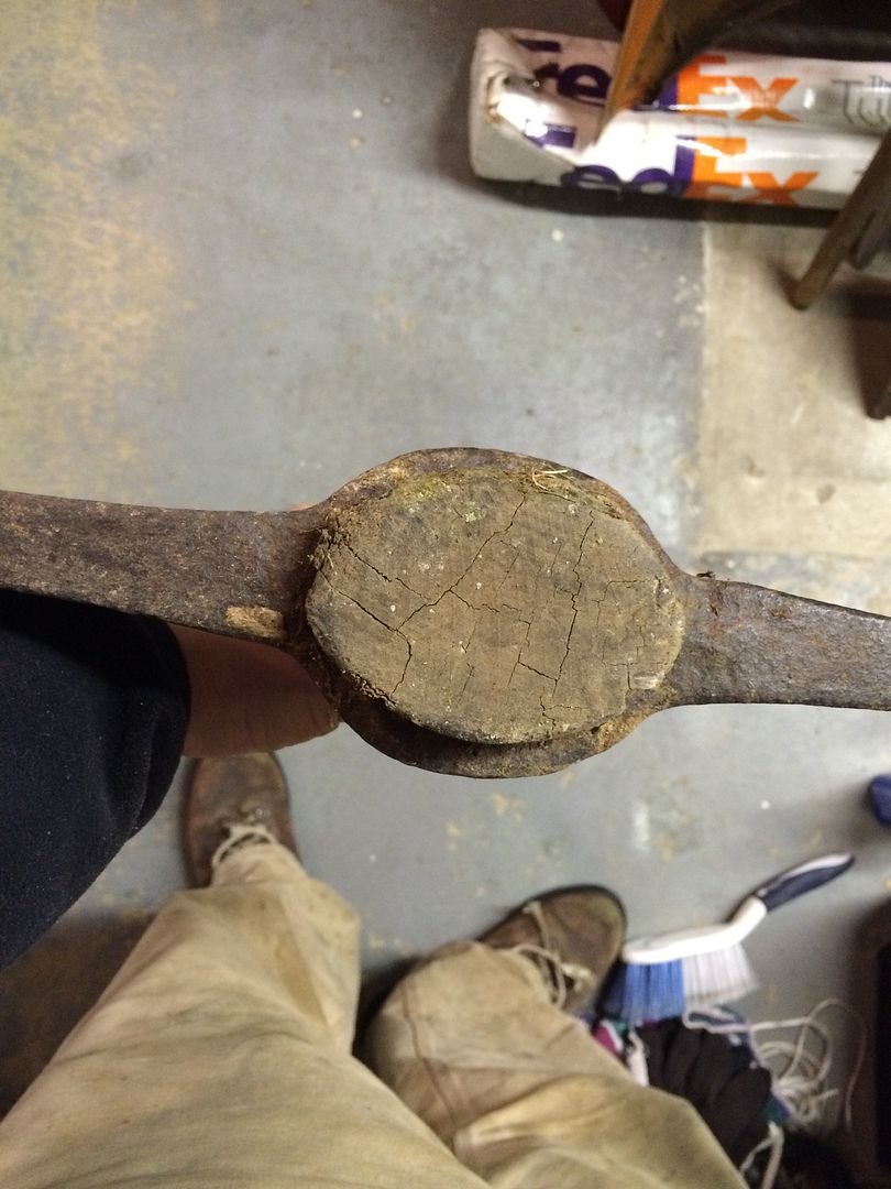

Another tool I tried very hard to break/destroy as a kid... I can't read the sticker on the handle anymore and there are no markings on the pick. Probably Craftsman. I know some axes are handled this way (round eye). Dirt is falling out from between the head and the haft and if I remember correctly, at one point the head was loose on the haft and I don't think it ever got fixed. I just cut down a pretty big tree next to the house and I promised to have the stump gone by snowfall so we can plant a new tree in the same place next spring --so I'll use this a bunch ASAP. What do I do to care for/maintain a tool with a round eye like that? Are you supposed to use wedges? Do I just slam the head down and use a bunch of BLO on the haft?

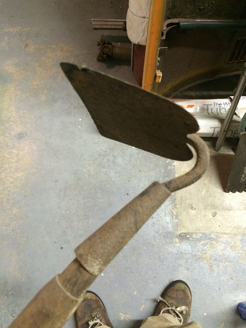

I took a bunch of hoes and flat-blade edging shovels all handled like this. They are all my grandfather's vintage, not dad's. Do I just clean up the wood, gently put the metal collar back on and generously apply BLO? Do I use Swel-Lock between the metal collar and the haft or will BLO be fine?

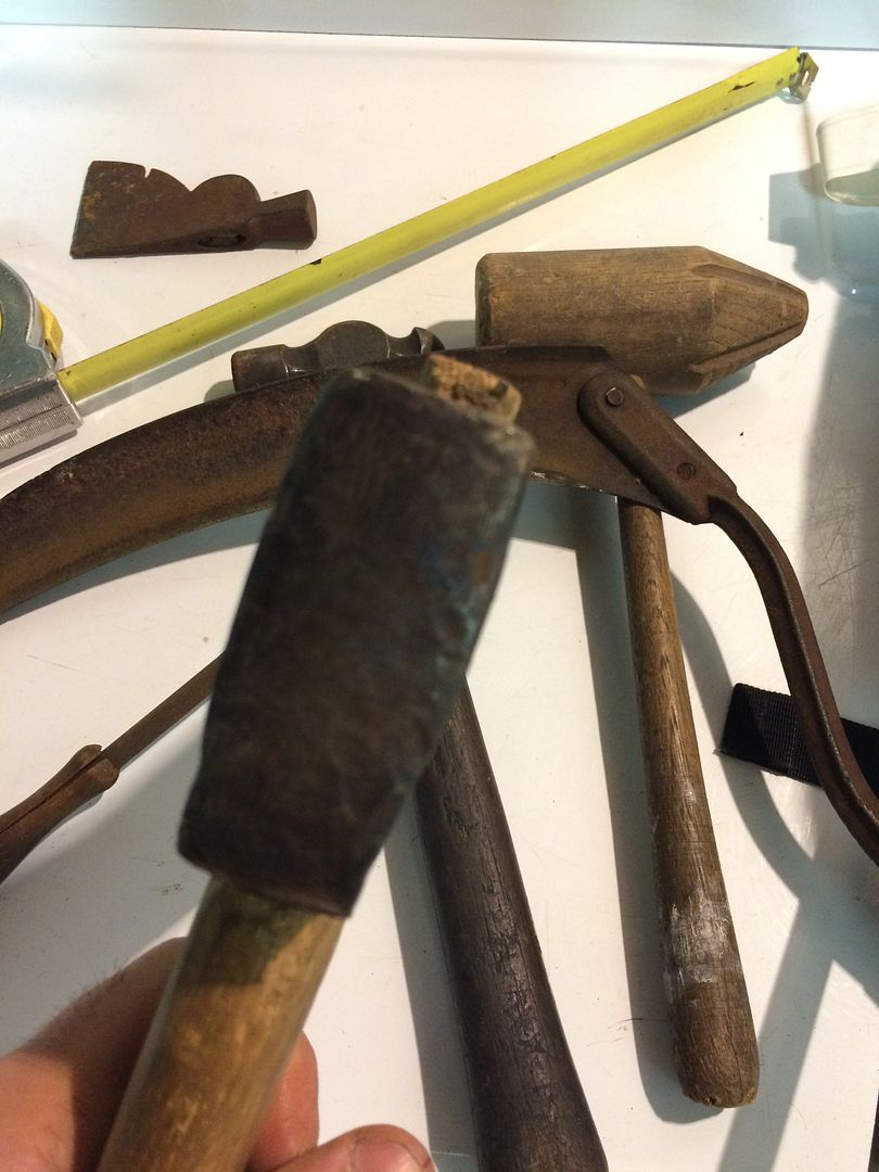

Made me smile and laugh when my mother said she hated this sickle. It was my grandfather's so my dad refused to get rid of it. She said they used to have to hide it from us because if we found it we would either cut anything/everything we could with it (probably the flowers in the front yard & garden) or one brother would be chasing/trying to kill the other brother with it. :D:D
So what do I do with it? There are no markings/stamps on it anywhere. Same as everything else? Clean the wood and apply BLO? I'll probably keep it sharp (already sharpened it last night) and use it here and there so how do I own/keep/maintain it so it doesn't keep rusting away and the handle stays fresh?

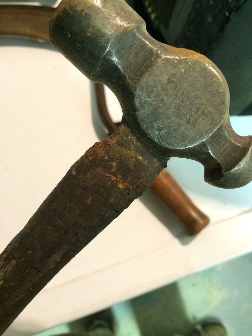

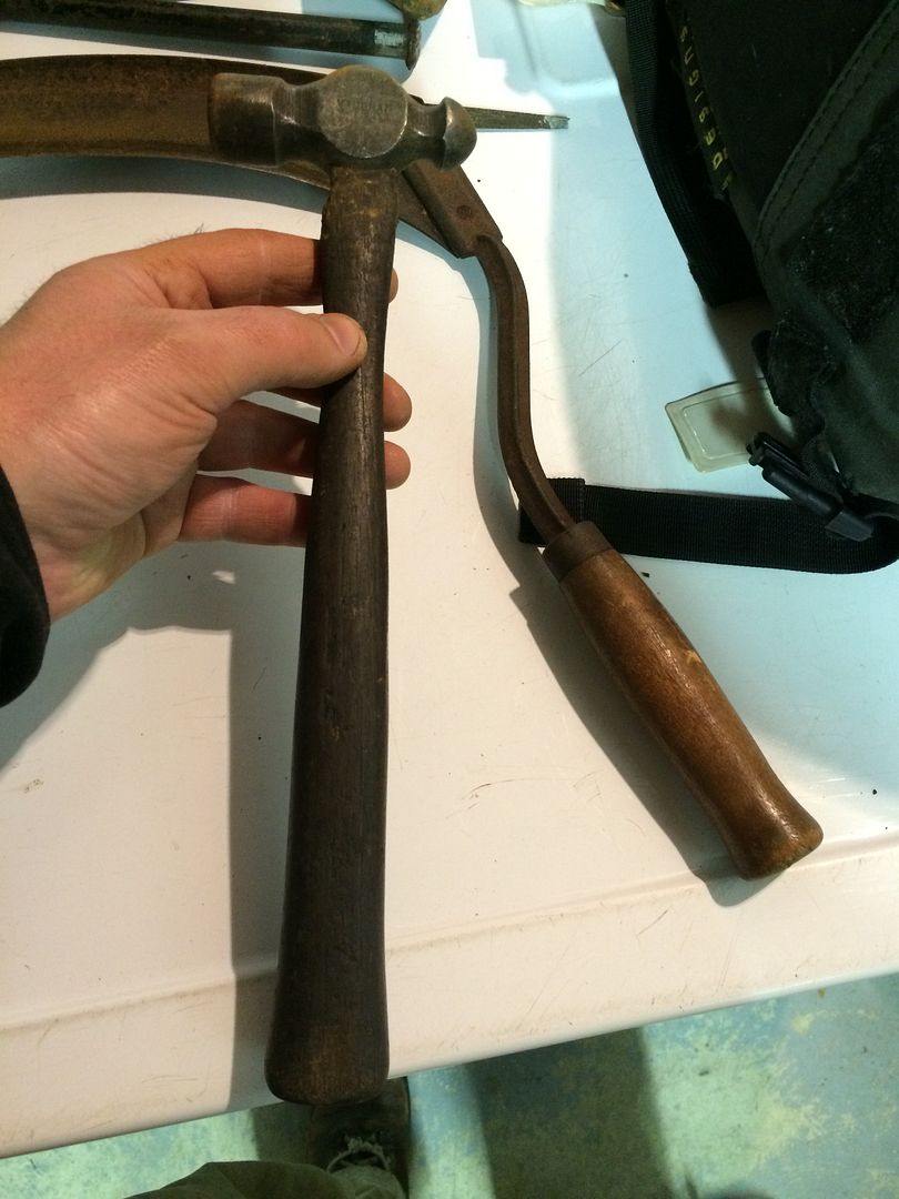

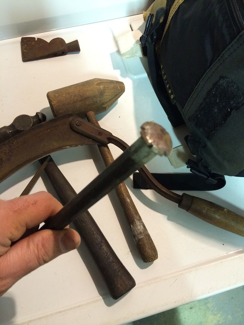

To keep this short, that's one of MANY hammers. I just picked up two or three milk crates full of haftless axe and hammer heads at an estate sale and I just got about twice as many from my dad. Almost all of them are stamped like this one with Vaughan. I don't know that brand, is it good? If its a low-quality brand I'll probably box them so they don't get destroyed vs. use them. Many of the hammers with handles are like this --oily and gross. How do I clean and care for an old handle like that? Should I start buying BLO by the 5-gallon bucket? With the heads that are without handles, is it the same as an axe? Measure, figure out what size I want, place an order with HH and have at it? Is there anything different with hafting a hammer vs. an axe?

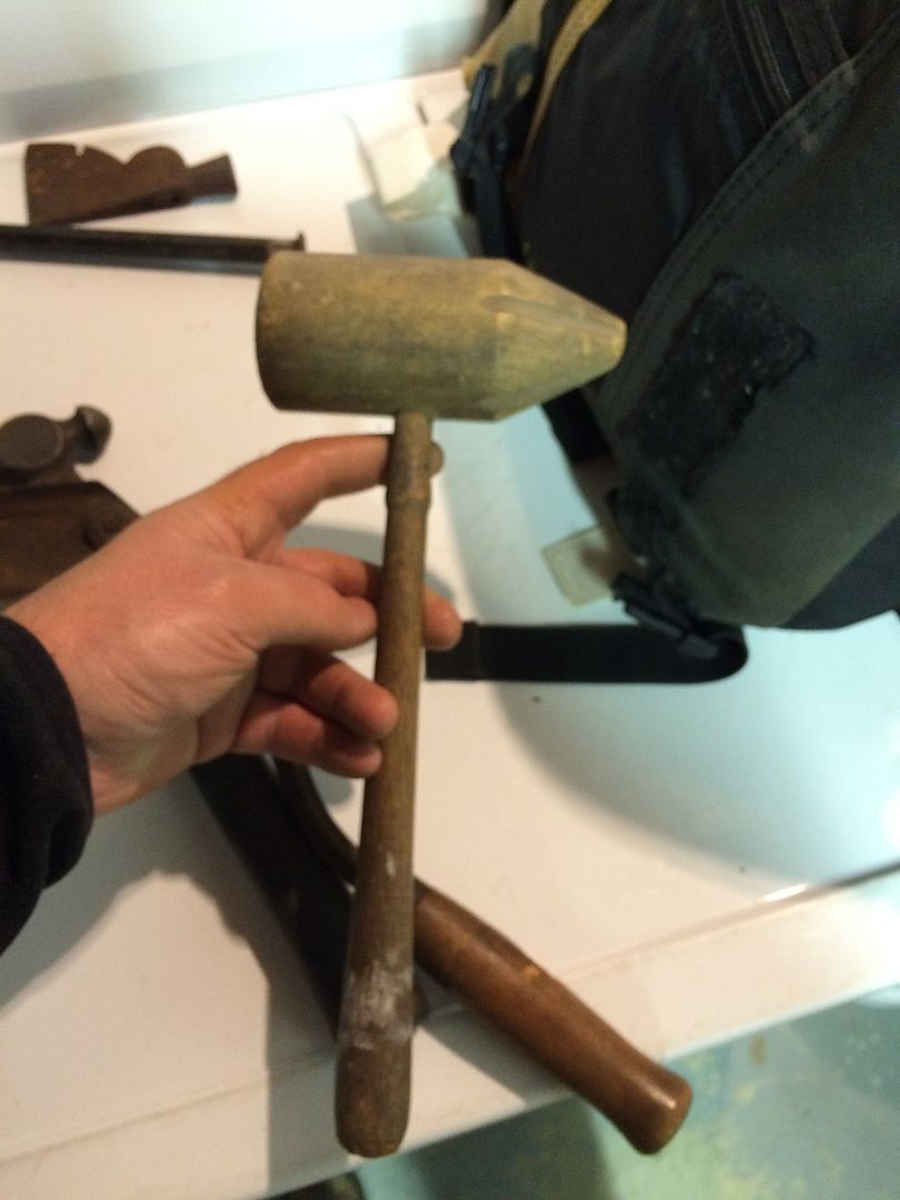

There were a couple wooden mallets like this. Almost looks like they were used to hammer/close paint cans. They all have that same notched point. What is that? Also... Is this the type of wooden mallet that would be good to use to drive in a kerf wedge? How do I maintain them? BLO like everything else? I'll use them day-to-day but they have about 40 years of dust and sitting so they are pretty dry. Don't want them to crack or fall apart if I start using them.

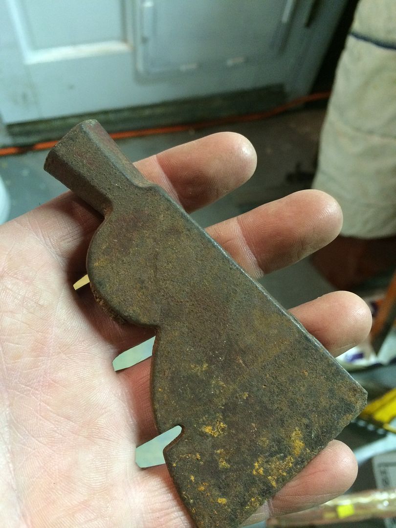

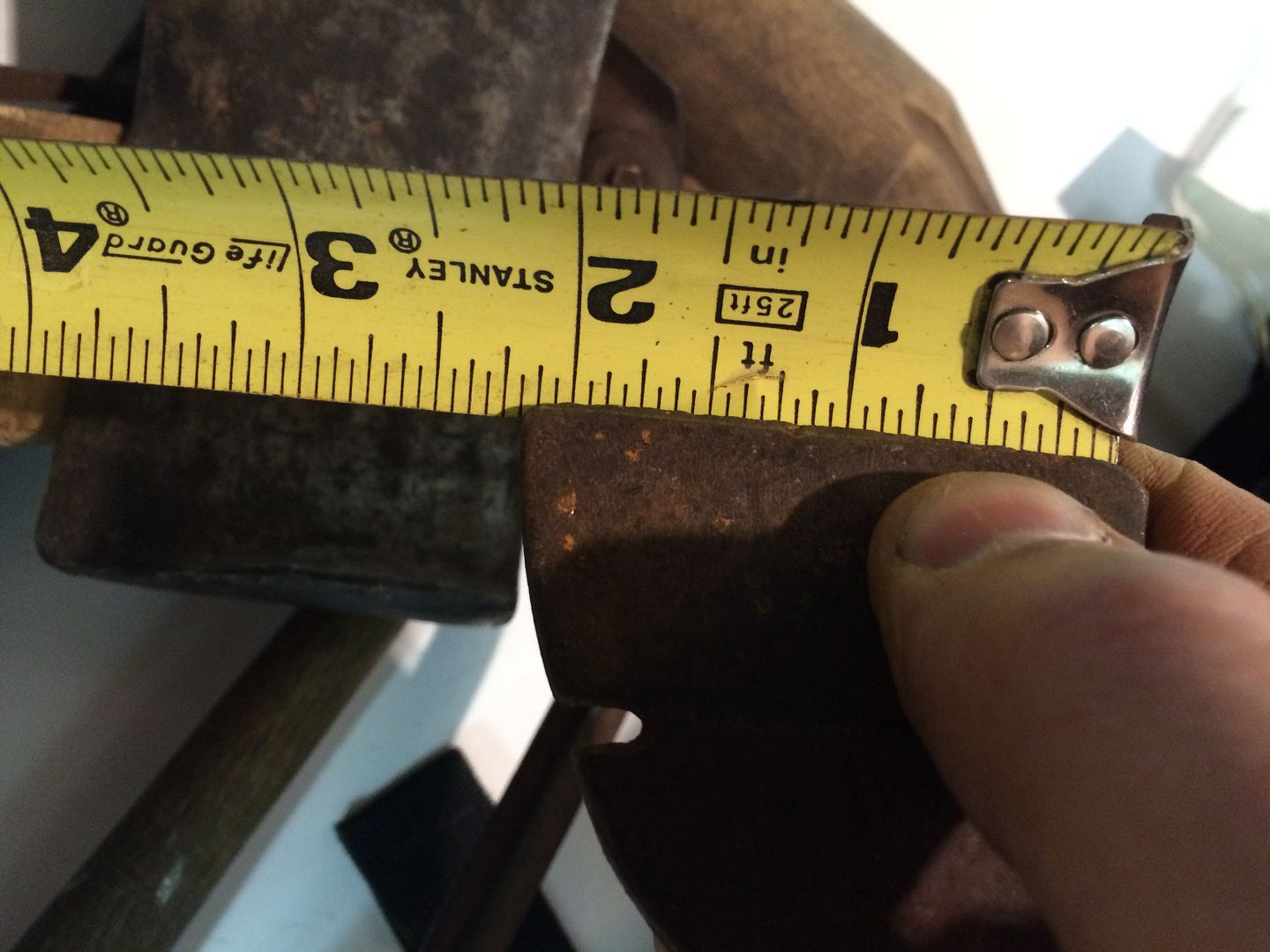

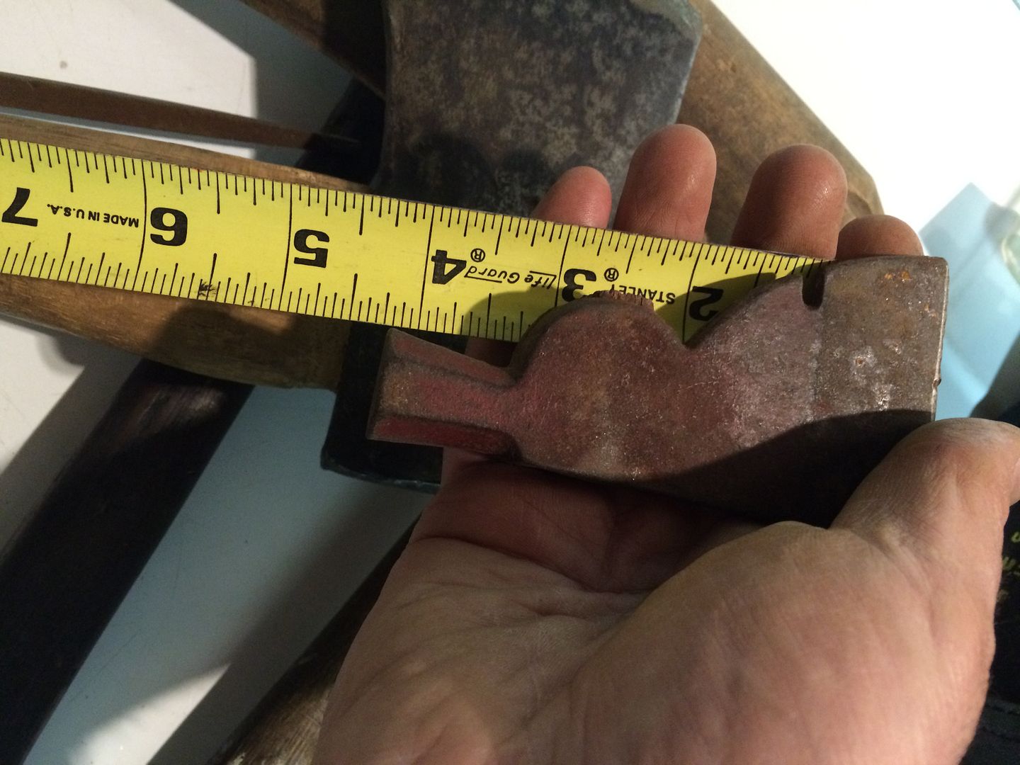

What the heck is this thing and do they even make handles for something that small? Is this what people refer to as a mini hatchet or mini tomahawk? There are no markings on this anywhere (that I can see) so I have absolutely no idea what it is or how old it is. I can see it was red up until about 1" back from the blade. There are two more like it. One is identical as far as I can tell (I think I alternated between the two in the photos) and the other one is a Craftsman branded/marked tiny little thing.
What would this be used for and is it some miniature reproduction thing or is it legit enough to handle and hang on the pegboard and use as a proper tool? Meaning, is this a child's toy vs. a proper tool? Could have sworn I took pictures of the Craftsman one but maybe because I could ID it I forgot. Will take pictures and post them over in the mini-hatchet thread in case anyone is interested.

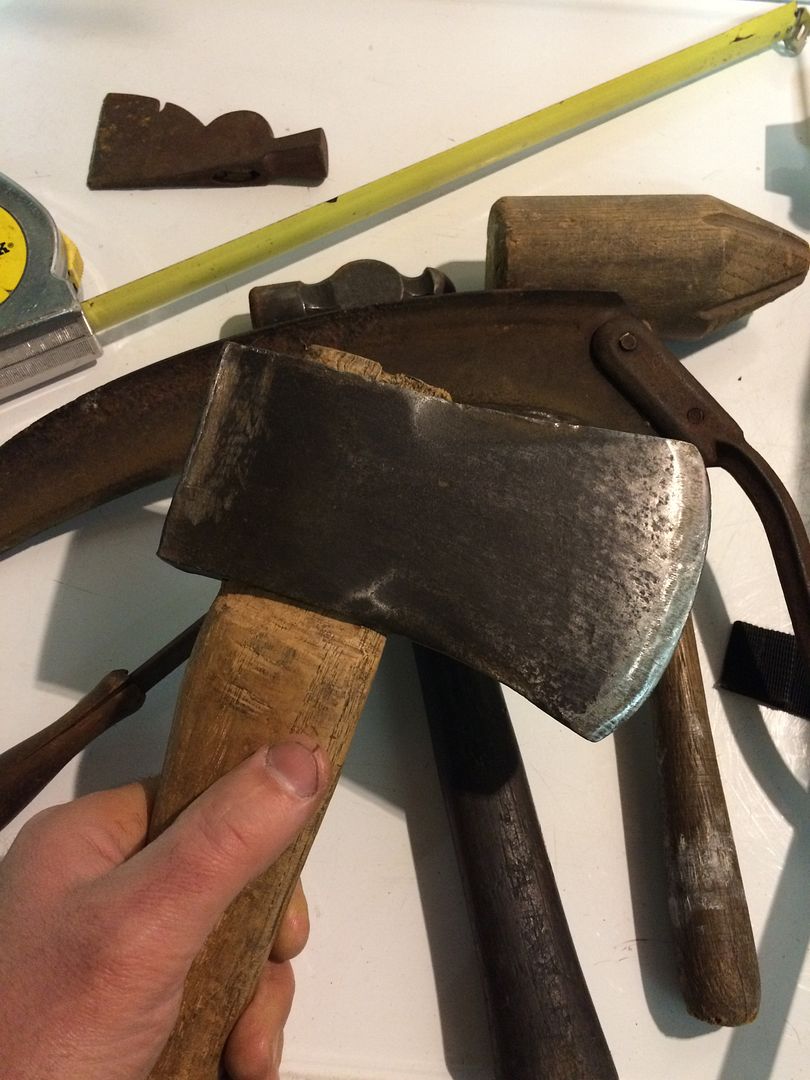

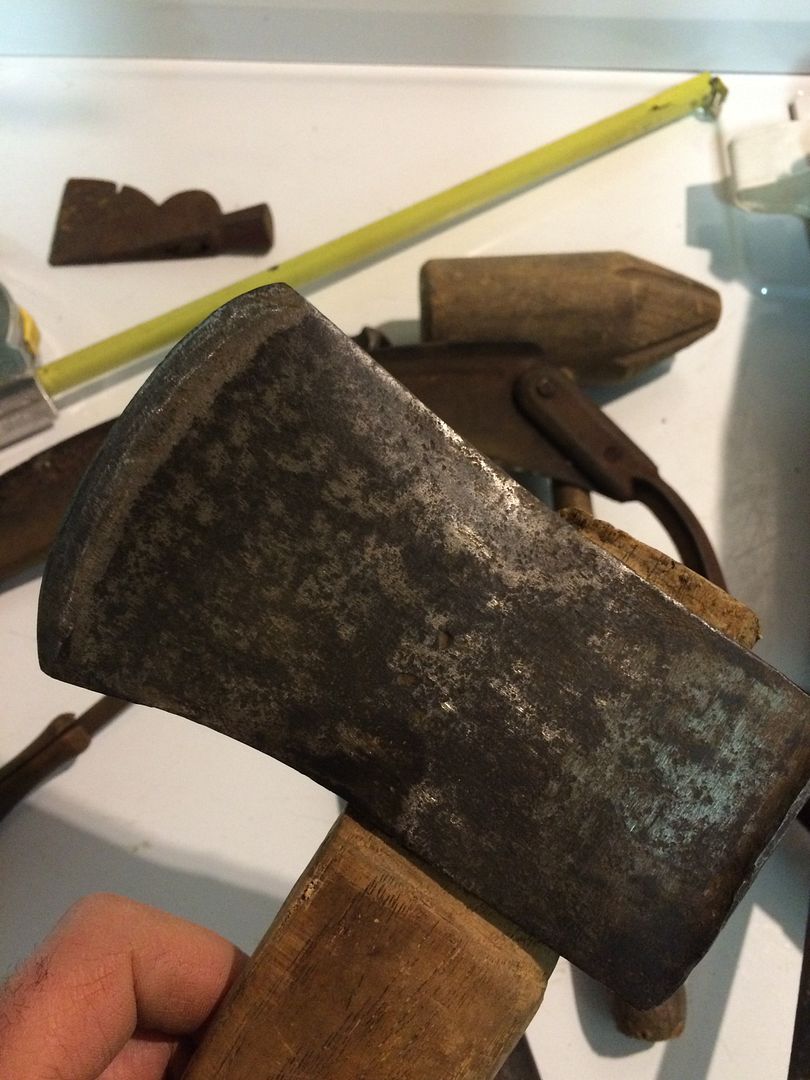

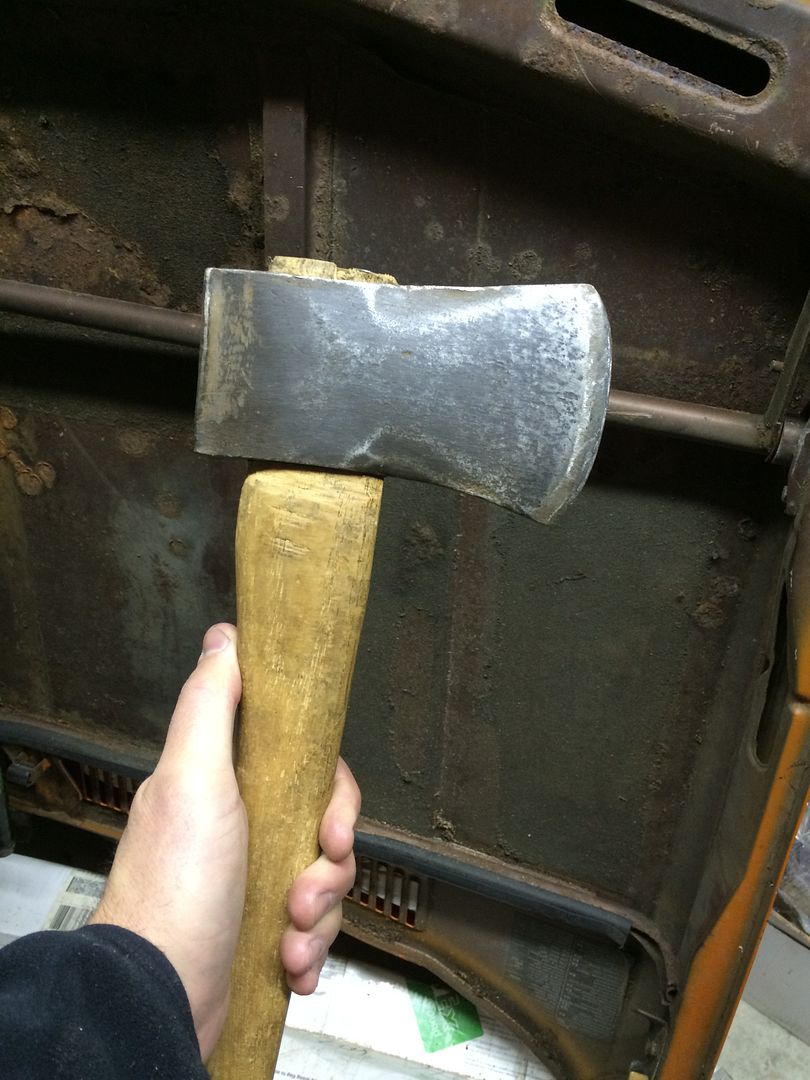

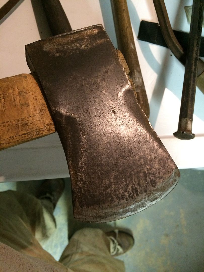

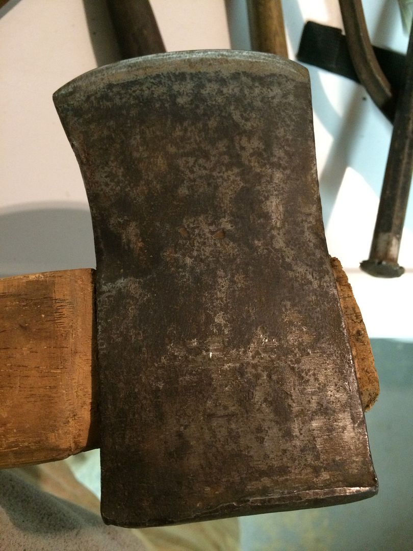

#2 on topic, boy's axe. This was the first axe I ever swung. Only hatchets in Boy Scouts prior to this. No markings on it and it looks like at some point someone took the entire head to a grinding wheel. Could have been me for all I remember/know. I do remember my father re-handling it several (maybe 15) years ago. I may not know the brand but I know it was his as a kid which is all that matters. My questions about this boy's axe are can I re-use that handle and do it properly or is it junk? The head is tight on the handle but its not properly on the shoulder of the haft and there seems to be a little bit of everything shoved in the kerf slot. If its bad I'll just use it until the head gets loose and then re-handle it. If it can be saved I'd rather reuse this handle... but how do I get all that junk (and the wedge) out of there?
The big saw is a champion tooth crosscut felling saw. Good looking saw from what I can see. Cleaning is up to you.
Bob
Just grab whatever you can. You can sort it out or figure it out later. Once it's gone it's gone. I like the mini hatchet. Those are popular among collectors. The shape of the full size axe reminds of a Warren. Warren used bevels with that shape.

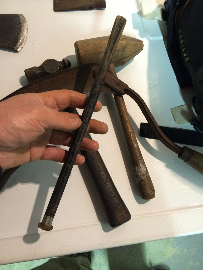

The felling saw is a nice score. There are a million of those star drills around. No value there at all except sentimental value.
I have/got all of that stuff and a whole lot more. I told (asked nicely) them not to throw out anything and I'll take it all. They have filled up most of a 25'x50' garage/barn section.
How do I care for the wooden handles? Just rub them down with a rag soaked in BLO? Also, anyone have good any ideas how to take the handle off of that boys axe head so I can re handle it properly?

Sand them down first, then oil them several times with BLO. Try brushing BLO on the end grains of heavily weathered handles - those end grains will really soak it up - more than a rag can supply.
How to remove and re-use an axe handle:
http://www.bladeforums.com/forums/showthread.php/875111-Remove-an-axe-head-and-reuse-the-handle
The star chisel is used to break concrete.
Indeed! Since the invention of air tools, and then electric versions, there aren't many of these being sold anymore. But the star shape is still in common use as bits for concrete breakers.

The "sickle" (actually a scythe-type grass hook) was made by the North Wayne Tool Co. of Oakland, Maine, probably in the 50's. It looks to be a No.8 "Little Giant" model. If it had holes in the blade for adjusting the blade angle it would be a No.9. The cruciform shank on those is pretty distinctive. You want a super-low angle of about 7-9° per side with the scratch pattern facing forward (running from heel to toe.)
