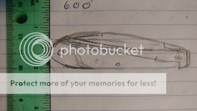

...So it started out with a sketch I had done while I was working on #3 and waiting for something to dry...I'm not an artist, as the following photo attests but it gave me an idea of what I wanted....the plus side of having a crappy drawing is no matter how the real thing turns out you can say "That's what I saw in the picture!"
Now this was #4 and the first one I've done from my own design. I'm sure I've probably seen the pattern some where before but I can't remember where.

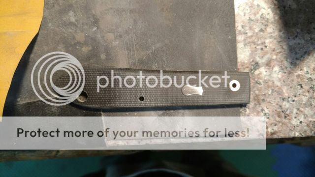

My first attempt at a shield was a FAIL...TO LOW!!! (I did practice a few times before hand and they came out beautiful. I guess she just didn't want to wear black G10). All I had left was green canvas Micarta. Pop the liners off the black...onto the green..cut down to size. Measured many times where I wanted the shield and VOILA! (It really wasn't that easy for me...I cursed many times in the process.)
