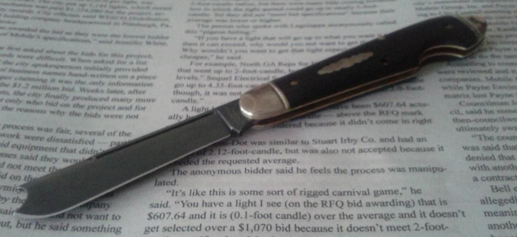

Many modern iterations present a nod to whatever tradition existed previously (I'd love to see a functional old one), but without the geometry in the blade-end cut-out that make them truly one-handers. The Case linked to above, for example, looks far too blunted to reliably "catch." GEC's newer 85 looks functional, but I haven't heard of how they perform.
-- Note the prominent "hook" at the spine there at the end.
I'm looking forward to the TC razor barlows because I think these blades are wicked cool, and I know "functionality" is currently on the list and not just looks.

But having said that, I have one of the GEC #85s that Pertinux shows above. I make a practice of opening one handed on my jeans watch pocket or belt loop, to see if it really works well enough to be practical. I can get it open reliably, but I have to be careful. Two things inhibit the function a little a) GECs strong pulls on the #85 b) the half-stop - its easy to get it out half-way, but harder for step two. I can imagine that a traditional knife with no half stop and a lighter pull would be pretty easy to open and practical, on the other hand, maybe the half-stop is a good extra safety to have in spite of the inconvenience.
I know that GEC's next Charlow will be a razor pattern, I wonder if they will forgoe the half-stop or make it a lighter pull.
-- Note the prominent "hook" at the spine there at the end.~ P.
Curious about the 85 pattern. I would think it doesn't have a half stop and is fairly easy to open, considering it's a one hander.
If you own one, please post.

I'm betting it's like a lot of knives, with a wide range of functionality (or lack of), depending on design/build quality. Just looking at pics of some of the 'less expensive' ones, it seems like there's not enough 'notch' at the end of the blade to reliably catch/grab a belt loop or whatever (Sarah's posted example of the GEC version's deep notch looks much better, in this regard). I'd think an excessively stiff/difficult backspring could be troublesome as well, as could poor placement of the blade end or notch, when in the closed position (blade too low in the handle, for example). I'm sure many of the modern iterations of these are just nostalgic throwbacks to the design, with little thought given to true functionality anyway. In that case, those would definitely be the 'silly' ones. ;)
David
see above, it does have a half-stop and a pretty strong backspring :)
Mine is in my today for Wooden Wednesday. I've carried it over a few weekends and the design does indeed allow one to open with one hand. It's not my first choice to do so.
