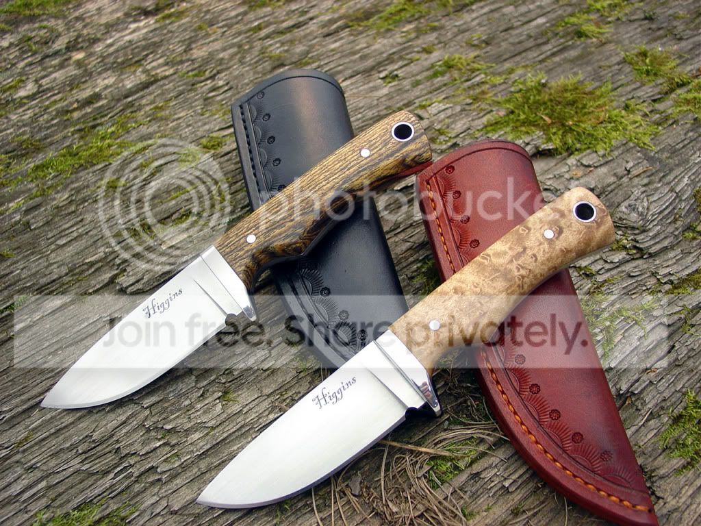

2 because that works good for kiln heat treat, quench plates and dry ice at the same time.
