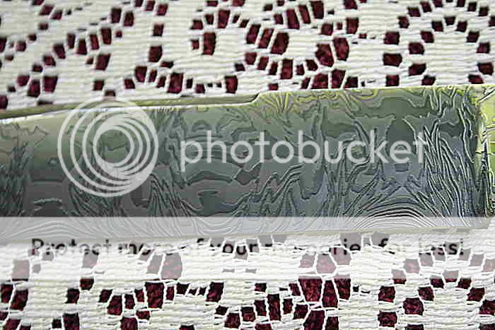

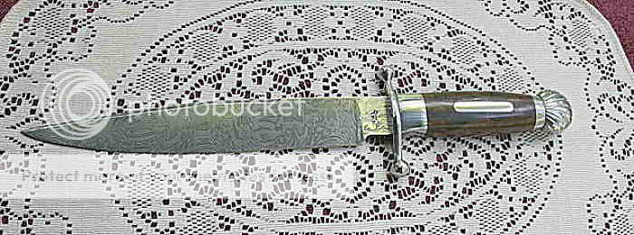

Even though the show is still a couple of months off, I've started building a few with it in mind. Here's the first:
The blade on this one is 1084 & 15N20 as is the bulk of my Damascus. The handle is ironwood with 416 fittings. I guess that you could call this one a Peter Rose type Bowie with a mosaic Damascus blade. This Damascus pattern is from a billet of varied thicknesses which was "W"ed & accordion cut.
Let me know what you think.

Nice piece Gary, good that you have been working out front of the show a bit.
Will result in less pressure as show draws nearer.
