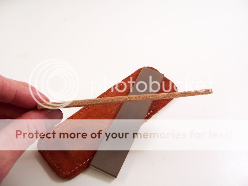

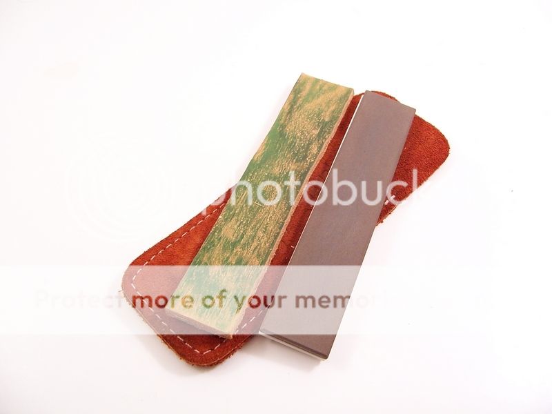

I have been trying out a Spyderco doublestuff with a nice piece of stiff hard leather with green compound. All fit in the swede pouch and fit nicely in the pocket. You can maintain an edge for a while with them.
