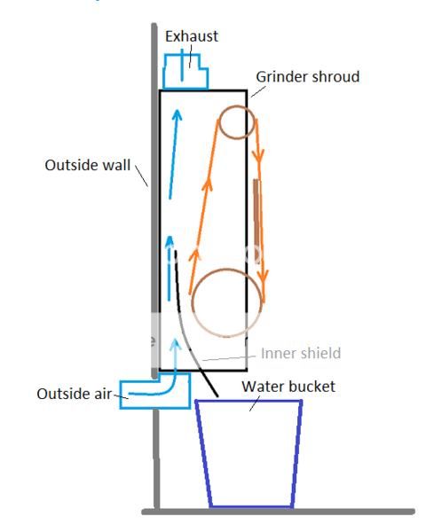

The one thing I will continue to mention in these threads is the need to address the dust you don't see. I found that the true danger is the fine dust that gets caught up in the air currents produced by the grinder, itself. That stuff does not go into a bucket or funnel under the contact wheel/platen. It gets spit back up and hangs in the air. IMO, you need a shrouded grinder with appropriately placed exhaust ports to collect/vent the fine dust more than you need to keep your floor clean.
Clip a magnet to your hat/shirt and grind for a day... You'll see what I am talking about.
What's a good way to shroud a grinder?

Best way is to buy one direct from your grinder's maker. Barring that, build one using sheet metal.
Or wood that is lined with sheet metal. My Grizz was easy, some grinders are more difficult than others. Keeping it simple for belt changes is tricky.
Thank you. I wonder if there's a radius that dust is airborne and then settles. I don't think I'd want to put in a system like that. I mostly want to keep dust out of the non-knife part of the garage. I've also toyed with the idea of some type of modular curtain or wall that encapsulates the grinder area. Maybe a welding curtain?
You can isolate your grinding area with doors or segmented curtains. Just make sure you wear a respirator... full face(or with goggles) if the area is tight. I would want an positive pressure mask in a closed room.

But seriously, for a grinder like a 2X72, 6X48, etc., you need a LOT more airflow to get the fine dust than you can get from a shop vac. The flow range recommended for sander/grinders in that size range varies from about 800 CFM (OSHA) to about 1000 CFM for European authorities. So my target is 1000 CFM in a 6" duct, which hits the 5,000 feet per minute air speed it takes to move steel and abrasive dust. It takes at least a 2 Hp dust collector with a short duct run to do that. Our hoods are designed to capture the air close to the point of grinding, which means taking the sparks too. Spark traps can be almost as expensive as the dust collector. And then you'll need flame retardant HEPA filters if you are returning the air to the shop. There's probably about $3,000 invested in the dust collection system on the Bader B3.

I hung a 20 x 20 " box fan right over my grinder and have a 20 x 20 filter on it . It needs to be replace often as it catches the dust your are referring to Rick .
