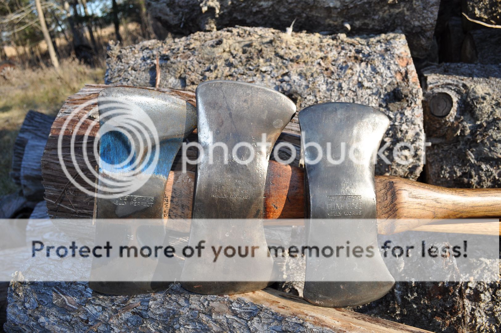

I will likely be speaking for a number of folks when I advise you to find a reasonably priced vintage head with "good geometry"/ convex cheeks and a lot of life left in the bit and then rehang it on a nice 30-36" handle (depending on preference). A nice vintage Dayton pattern from Kelly, Plumb, Collins, etc. can usually be found for less than $20.
My current favorite is a no name Dayton with nicely convexed cheeks on a 32" straight handle.

I would have U look at a vintage 3.5 lb connecticut pattern on a 32 inch handle. Very hard to beat IMO.
OOOhh I do like the looks of these, but this pattern seems like it's a little harder to find. I guess since I'm not in immidiate need, I can take my time looking though

The pattern isn't that important. A Dayton or Michigan would do fine. The old Kelly/True Temper stuff is fantastic. You also can't go wrong with Vintage Plumb. Many other vintages axes, too. A beautiful stamp is not required for felling.
If you will truly use it for felling then I suggest a 36" handle. The extra length helps. And it's good for splitting, too. But 36" is a little long for bucking or hewing unless your a tall fella - maybe 6'2" or over.
Don't give up on the double bits. Western pattern DB is the best in my opinion. It depends on the size and species of tree you're felling.
I love Kelly Perfect Jersey pattern, but they're not the best for hardwoods. They work great for softwoods. You can knock out a nice size chip in pine or red fir.

I don't think it is known for sure but one of my users is a paper label true temper wood slasher and it has the A23 stamp and the ridges in the eye
My parents got me one as a gift that had an A9 on it. It was sold to them as a true temper. I think Square Peg had one that was an A6 that he called a true temper too. Close enough for me I guess. Seems like very little in the vintage axe world is for sure :)
VERY hard to beat. When it comes to felling, the only axe that can outdo my 32" Connecticuts is my 32" Keech racer, which is 5 or 5.5 lbs (can't remember exactly). I like a nice, heavy head, but the more experience I get, the less I like anything longer than 33 or 34 inches.

If you are looking for a felling axe to do actual felling...A Kelly Flint Edge or a Kelly Perfect double bit is hard to beat. One could also look at a vintage Plumb or Collins for that matter.
A felling axe that has other uses such as splitting, bucking and felling a 3.5 Lb. Dayton or a Michigan pattern is hard to beat. One can use a double bit for splitting, but I would prefer a a single bit for that use.
Whether a single bit or a double bit, I prefer a 36" handle for that size head.
