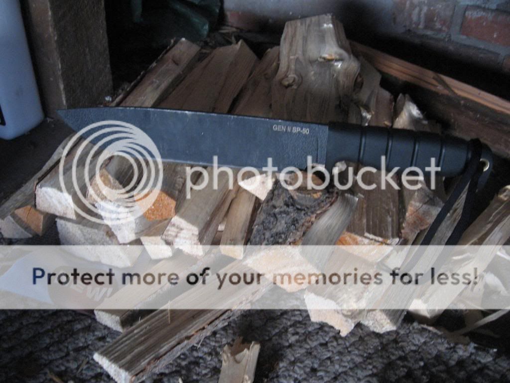

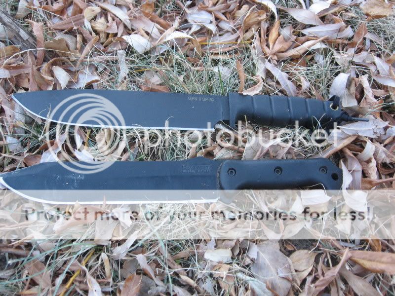

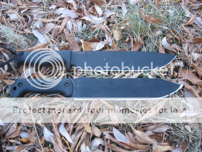

A not so little box arrived with this blade inside. First impressions were all good. The grinds on the blade are perfectly even, the blade is dead on straight, .25" thick 5160, full flat grind with a 20degree secondary bevel. The handle is made from a very hard Kraton. Feels almost like plastic, but a bit grippier. Shown with my BK9 for comparison. The blade weighed in at a svelt 16.4oz. It is a touch lighter than the BK9.
The spine is noticably thicker, but the full height grind, makes it a pretty decent slicer.

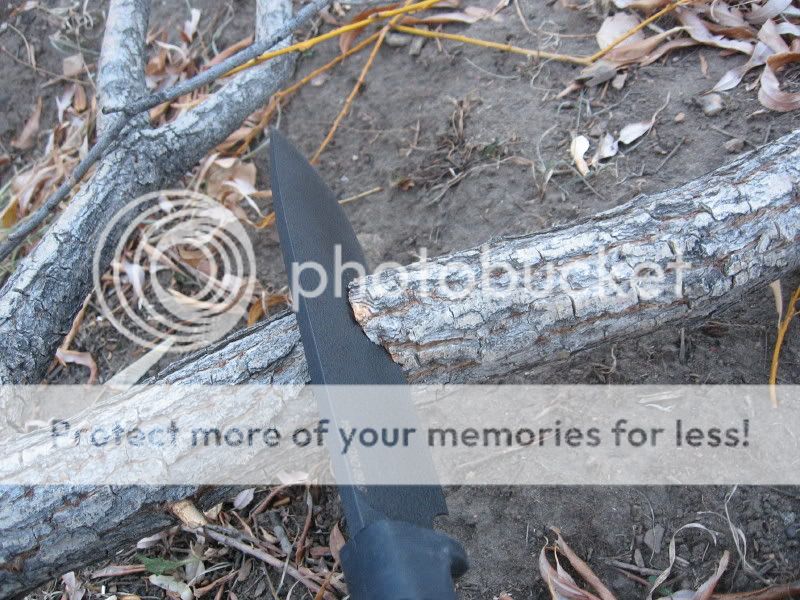

First swing and she easily bit deep into some willow deadfall.
It is a very comparable chopper to my BK9. I convexed the edge on the BK, so I feel that gave it the noticable advantage, not geometry. The geometries are similar if you do the Trig. The coating is thick and durable. I think it is the same coating that is used on the Ontario RAT knives. It is a touch sticky when battoning, but smooths out pretty well. It is thick, so it will last a bit.

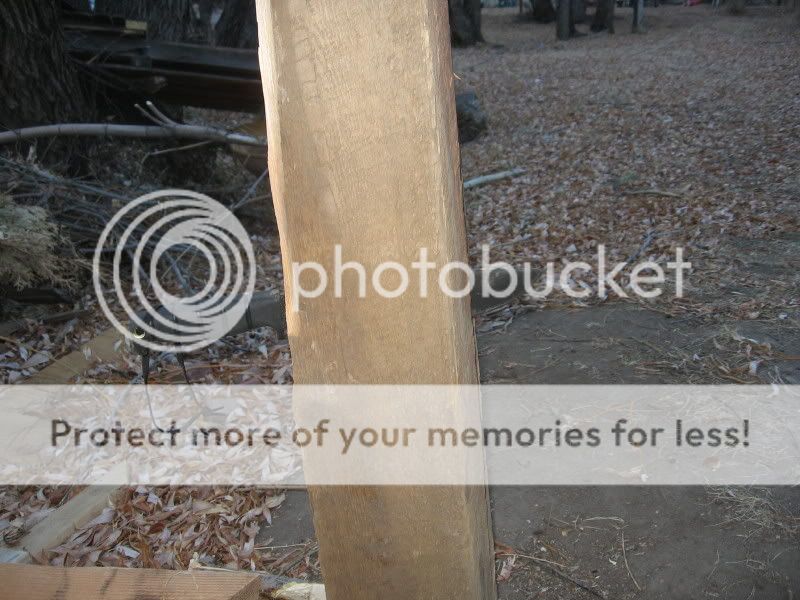

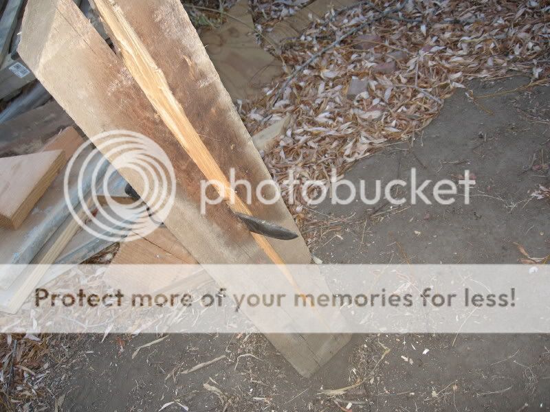

Let's see what she will really do. A seaoned 6x6 support log.
Right down the middle!

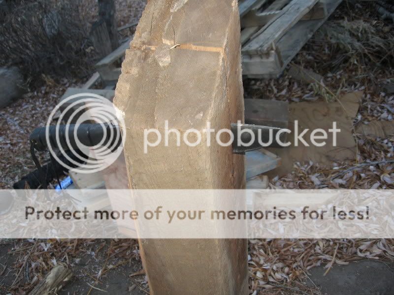

I put a lot of pressure on the blade and really beat it hard to drive it through the beam. I'm impressed!
With a loud pop, she popped in half.
Sheared through several knots!
More coming.

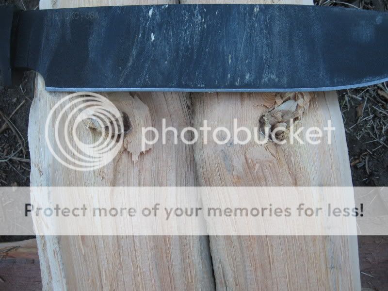

There was no edge damage to the knife.
Battoned into pieces!
The coating saw pieces of wood embedded into it. There was some black streaks on the wood that was split, but the coating held up pretty well. The edge is still 90+% what it was, out of the box.
