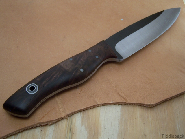

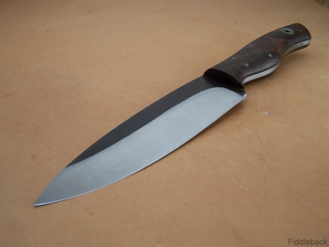

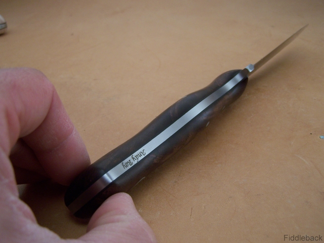

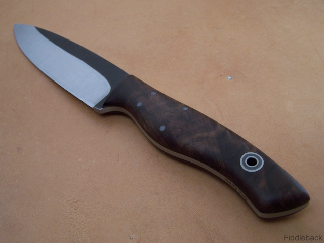

This one is wearing stabalized Walnut crotch and has g-10 (jade) pins, bullseye filler, and liner. The grind is convex sabergrind. Forge scale not optional!;)

Nice. Any feed back on how durable the G10 pins are compared to say stainless, or brass pins?
Used em a lot. Mostly pins serve to increase surface area for glue to hold. Very hard to remove scales with either. Japanese sword makers have used bamboo pins for centuries.
