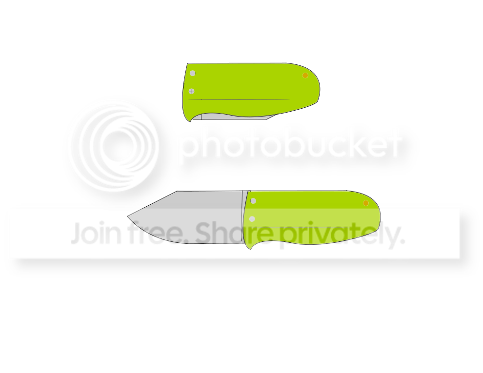

I'm trying to figure out a way to manufacture a opening method for this knife. It seems too thin for a thumbstud. I'm thinking about a nail nick or something, but I'm pretty sure I don't have the tools to do it. Saw, drill, bits, sandpaper and files. Anyone have a good idea? It has a 2.75" long blade, and around 3/8" of blade exposed at the first finger choil when folded. Also, if there's any design flaws, please point them out. It's supposed to be a liner lock, and the line on the scales indicates where the lock will be cut out, with the lock face starting from where the line stops. Thanks for the help!
I'm afraid I don't have the precision to drill a thumb disc with just a drill. As for making the choil deeper.. would it make the lock too thin?

The thumbstud only needs to be on the opposite side of the lock, so it won't affect the lock at all.
I don't know if that's all to scale, with the pivot and stop in their final location or not.
But, if it is, it is unlikely to work well.
You gotta have room for washers in there, and don't forget the detent ball and the arc it swings as the blade is opened.
You don't want a detent to fall off anywhere, or encroach on the bevel.

Make a plastic or sheet metal mock-up of the blade,lock side liner, pivot and stop pin. Find the lock position on the liner that way. Make everything exact size, and use those as a template for making the parts. I think you will have to move the pivot and stop from where they are drawn.

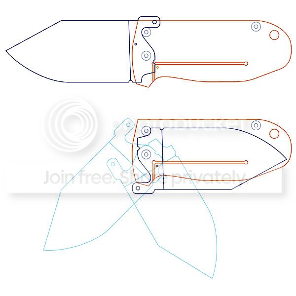

May I suggest an opening system like at the Burger Exkelibur?
See the schematics and the quick rendering below, they are self explanatory (I hope). If you need more details, I will gladly provide. Anyway, thanks for the fun, I enjoyed toying with your knife :)
Wow. Thanks a lot to all of you for your help. And dialex, that's amazing. What program did you use? That opening method looks very unique, and I'll probably go with that. As for precision.. yeah, probably gonna be problems there. But I'm just going to try and see what happens. Can't believe I forgot about the detent ball, hehe.
You are most welcome. The drawing was done using CorelDRAW, it's very good for this kind of things. BTW, if you need the file with the knife at full scale, just PM me.
