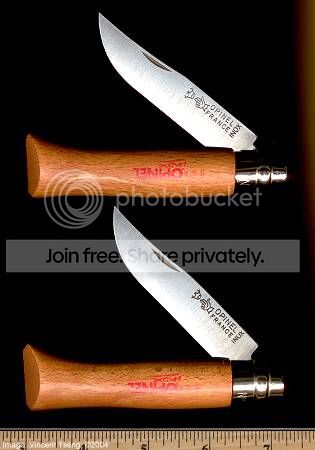

The Opinel #8 is the most popular size - the handle length is approx the same as a typical fixed blade hunter -

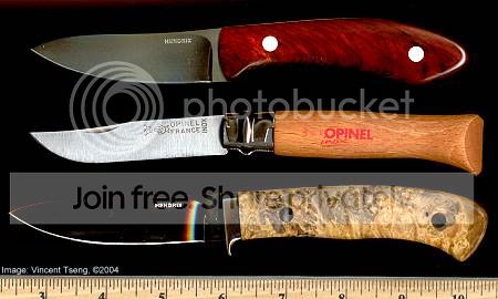

shown with - top to bottom Hendrix #11 (~3 1/4" blade, ~4 1/8" handle) Opinel #8 (~3 1/4" blade, ~4 1/4" handle) and Hendrix #1 (~3 5/8" blade, ~4 3/8" handle)

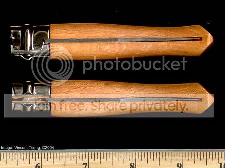

The newer ones have a cutout on the locking collar to lock the blade closed -

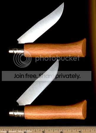

Details of the blade and stamping -
these two blade are the same, it's just a fortuitous anomoly in the way the two blades lie on my scanner that have resulted in lighting these two blades differently - therefore showing the differnt aspects of the blade(s).

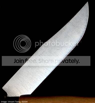

The Opinel blades are full convex ground - many say they are zero bevel edges - this is NOT quite accurate - examining the edges carefully there is a very narrow bevel on the final edge - I know these two knives have been sharpened by me - but I also have an unsharpened Opinel #8 commemorative from circa 1986 - that definitely shows this micro edge bevel
There have been posts that have discussed some Opinels have come pretty UNsharp - whereas many attest Opinels are some of the sharpest knives from the factory.....
Well...maybe.......both could be right? :confused:
Discounting knives that have managed to slip past quality control (and there are bound to be some) - I would say that my two samples here were real sharp from the factory.... but were also UNsharp.
No, I have not developed a case of schizophrenia (yet :D ) - when I examined both blades near the tip - I was chaised to find they were not only UNsharp but blatently BLUNT. So much so that I had to re-ground the blades to get these parts to be sharp (look at the tip) -
Being fully convex ground with only a micro edge bevel - the Opinels respond really well to stropping - either on leather or cardboard - and the blades even the stainless ones (my preference for low maintenance) can get truly scary sharp........

UVT: Those're some great Opinel's... and some gorgeous handmades. :D
D'you know if Mr. Hendrix is still "in the business"? His website seems to be down.

The image of the Hendrix #1 polished blade didn't come out that well - there are better and more detailed images posted in The Gallery section -
