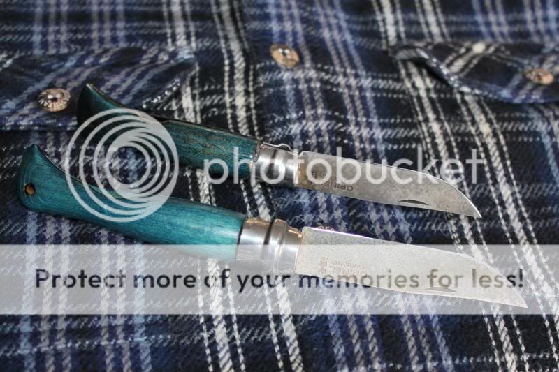

The knife on top (#6) is finished with High Gloss Lacquer. The bottom knife (#8) is finished with satin polyurethane and I think it gives the better feel of the two.
