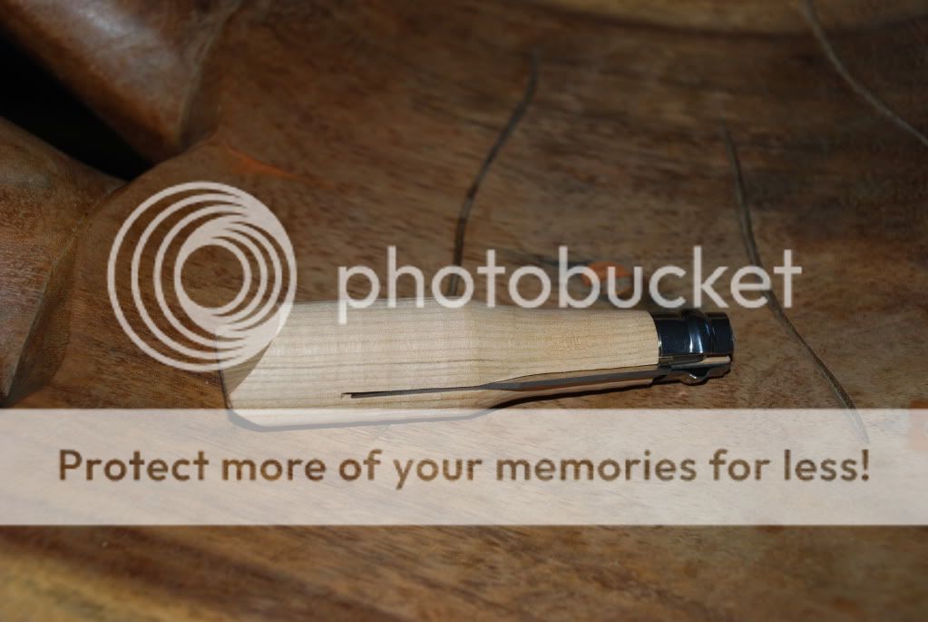

In case anyone hasn't seen them this is how they come to you.
They come in Walnut, Cherry and Maple over here.
