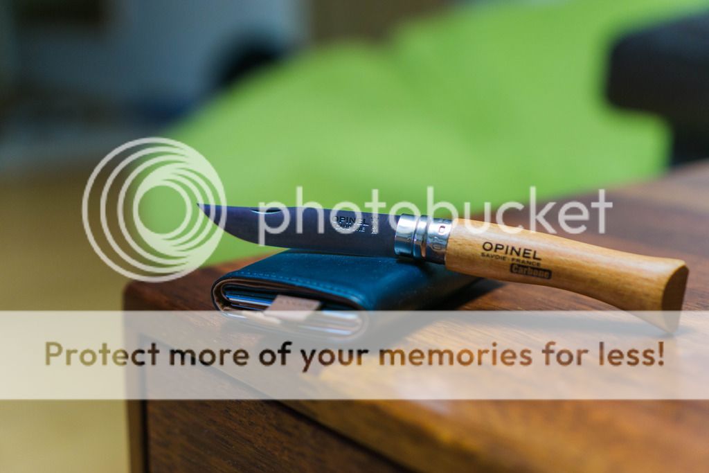

Opinel No. 7 - Patina

Can't see emotion through txt. Super easy to take things the wrong way. This thread went sideways fast. Anyways decent start to a patina. I have a spyderco Bradley 2 I tried to do a quick patina on with vinegar but that m4 steel for some reason did not want to take it well. I let it soak for hours and nothing. Switched to mustard and got some decent patina on one side and a lighter one on the other. So mustard did better than the vinegar for me. You should try some of that on there. Cover it in mustard then take a toothpick and and use the tip to scrape mustard off in whatever pattern you want then let it sit for a while.

Thanks for the advice on the mustard. I am pretty happy with how my Opinel is now. Maybe I will try to go further with mustard.

I force patina often to try to protect the blade from rust a little out of the gate. It looks neat as well if you do it this way. Just cut some paper towels into strips and wet them with vinegar. Then wrap the blade tightly and let it dry, overnight usually works. If you let them dry on the blade you will get a nice, almost black, color. Thing is, that will wear off and you will just end up with a lighter, more natural patina which you would get anyway.
So, a patina for me is mostly for rust inhibition.
Can I say I hate this ? No offense really... It's nice to experiment and some experiments turn out surprisingly nice. However, the only forced patina that really won me over was a dark blue patina achieved with cider(?) vinegar on a classic american pattern (Trapper, Stockman... ? CV, 1095... ?). It looked extremely good, because it was even and a gorgeous colour to boot. I suspect the quality of the forced patina depends not only on the medium used (vinegar, mustard, whatever...) but also on the type of steel. 1095 may not react like 1065 (the Opinel's steel).

Must respect for your opinion, and to some extent I sympathize. But my main reason for forcing the patina was to protect against red rust. I live in a place with very humid conditions in the summer. Also, I am not the only one who does this with carbon blades, and I was happy with my results. Philosophically, I agree that real use to obtain a patina may be superior. But I don't think there is any real harm done in speeding up the process. But thanks very much for your comments.

Actually I am not sure forced patina will bring you an efficient rust protection of rust would have been a real problem

I like to use onions. For two reasons. I like the pattern, and I like onions. So when I use my knife to prepare a meal, and don't have any onions, at least I know there was an onion involved. I tried to get a use patina on this one, but it was just getting rust spots. Stick a large vadalia for two days, remove clean and oil.
