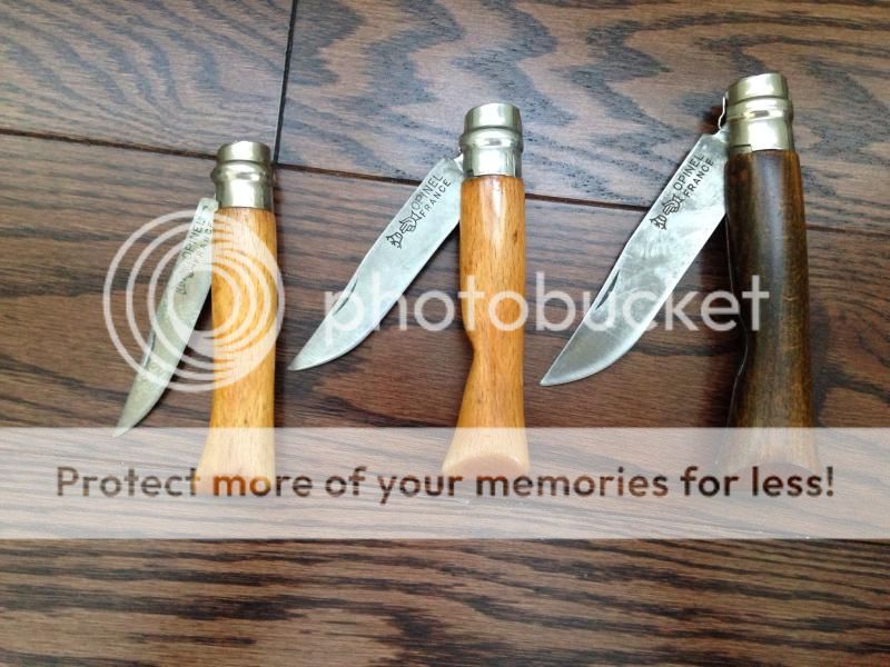

This is my loose one in Oak. I could tighten it up but it doesn't really matter since I use the ring
It originally came with an INOX blade but I swapped the blade out with a Carbone one. Should look sweet once it patinas up
