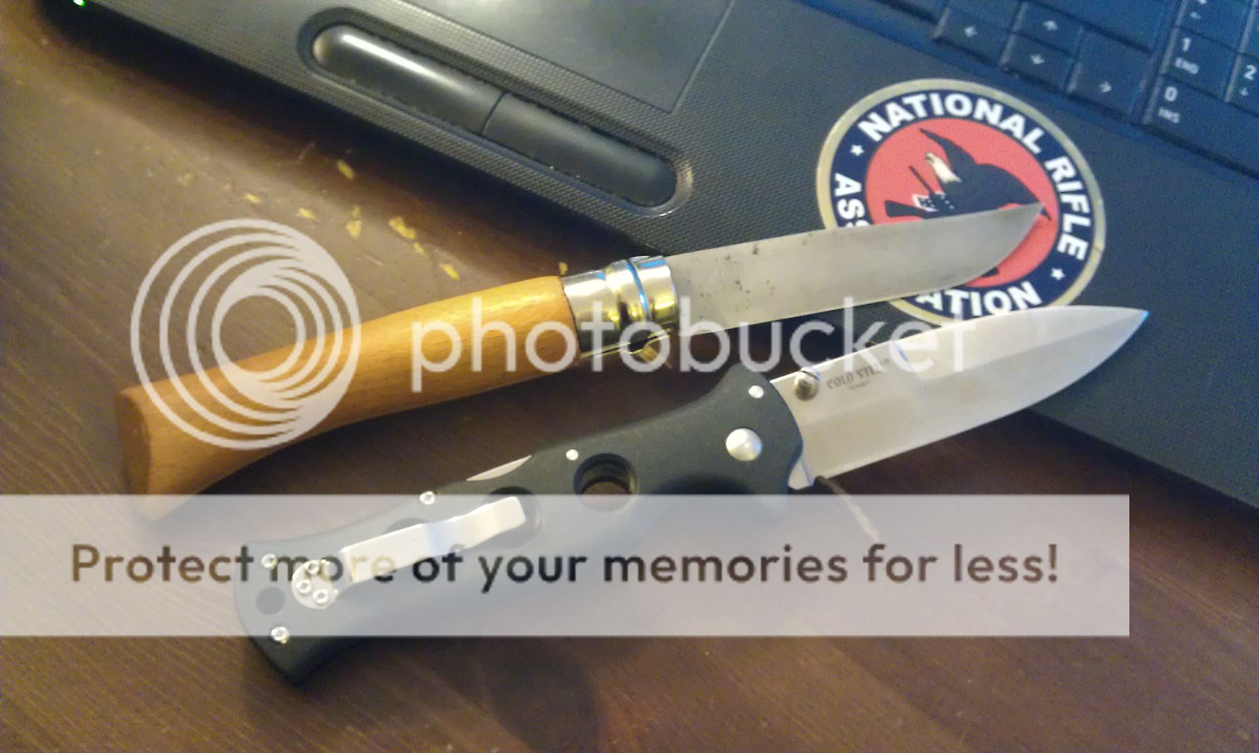

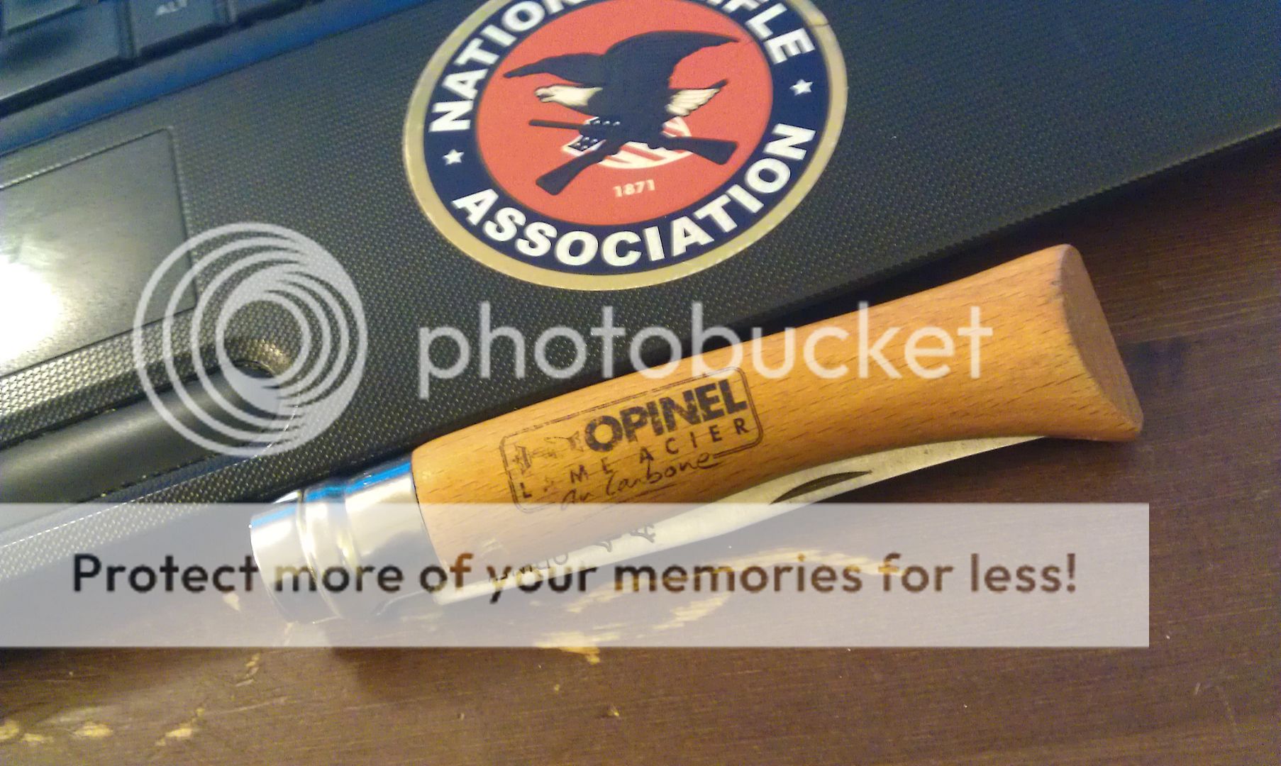

A "Tactical" Opinel that is. Haha. By "tactical" I mean thin, with a pocket clip, a thumb stud and a lock that will engage automatically. I'm looking for a modern or "tactical" folder with the super thin awesome carbon steel blade like an Opinel. While I really like using my Opinel, I hate carrying it because it's always moving around in my pocket, I have to use two hands to open it, and I have to stop to lock it. Also, the round handle is not pocket friendly.
I'm considering modifying my Opinel, while I can't fix the lock I can do the rest, but I'd also like to hear recommendations.
From this
To This?
