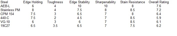

I've heard good things about AEB L from kitchen knife enthusiasts, and they are pretty darn picky about their steels. Devin Thomas uses it and makes some wicked pieces.
The other popular steel they tend to love is CPM 154.
Here's Devin's chart for some properties of steels he's used:

Thanks for the chart, Don. I find it interesting that Devin graded it that high for 'edge stability'. From what I was reading, there was some question about rolling and deformation because of super fine grains and marginal carbon.
