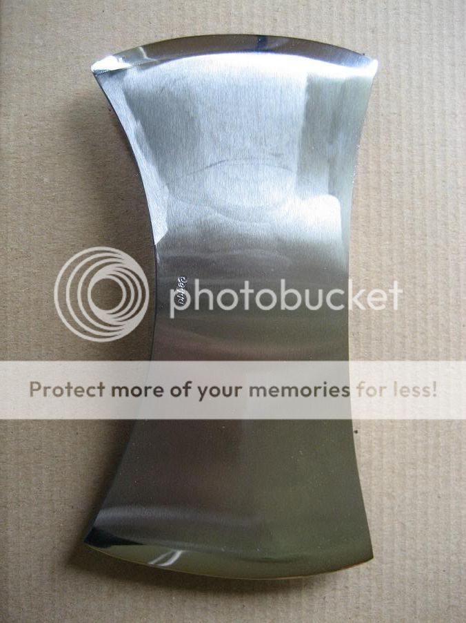

Wonder what the edge angle of a Cegga is?
From the pictures I've seen of his stuff his edges aren't as thin as a GB so they probably don't cut as deep.
This review seems to suggest that:

The GB is shaped like a throwing axe not something anyone would actually use for cutting wood. Word is that the cheeks are too thin to spit out the chips and that it likes to stick (as a throwing axe should and as a cutting axe shouldn't).
