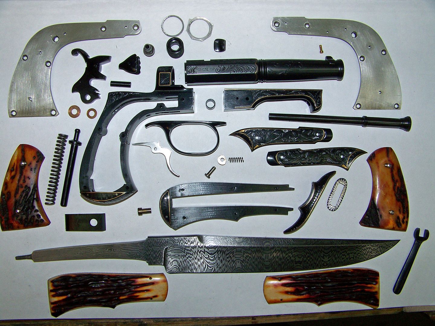

Mostly inside curves but great for contouring handles. Heres a fine example of what they can do. The barrel is about the only part that didnt get the dremel or foredom used.

BTW- Bruce's engraving was NOT done with a Dremel or Foredom.
Many people buy rotary tools thinking engraving can be done with them. It can't, effectively.
