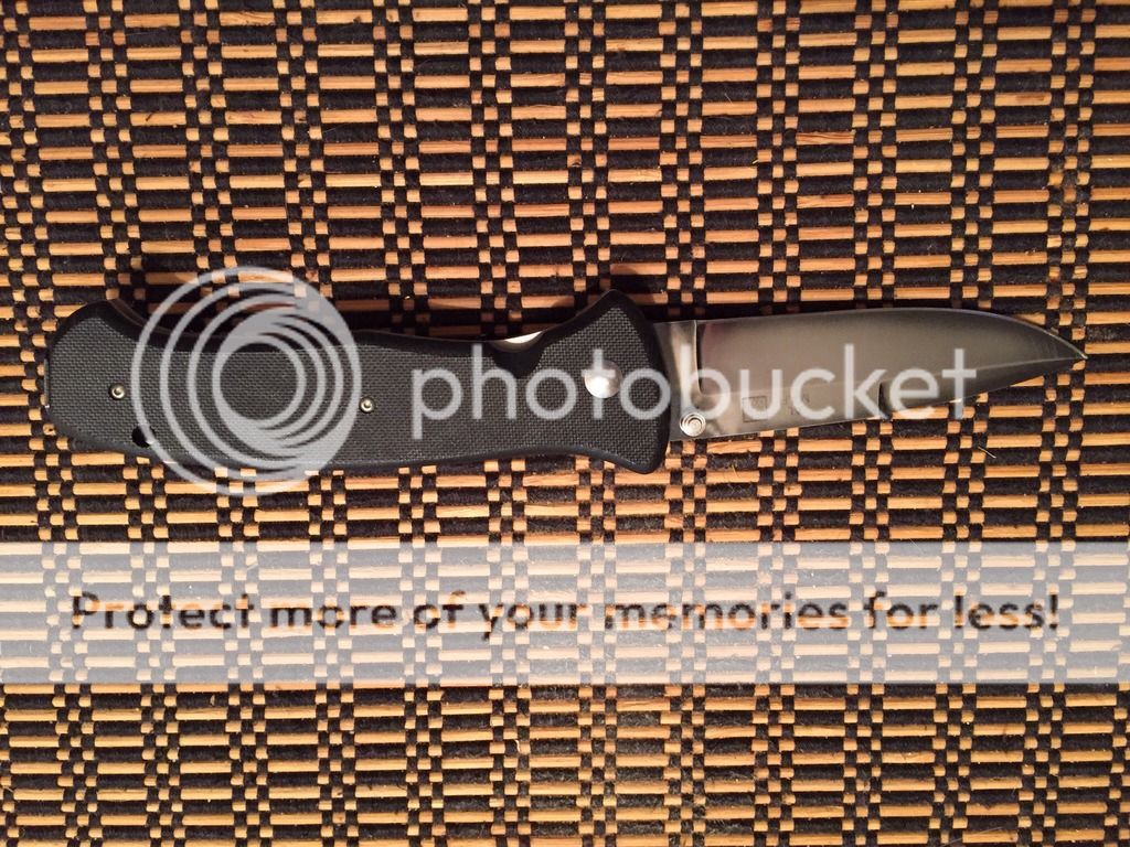

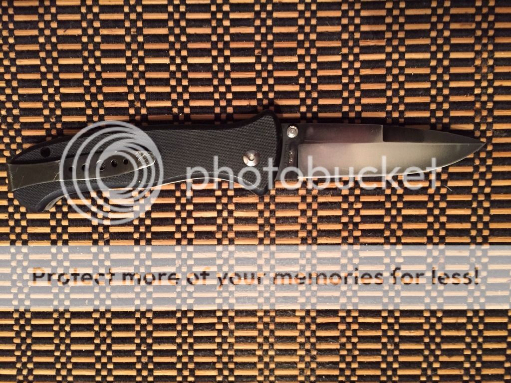

Found an Al Mar Sere. It had a bad scratch in the black coating so I decided to polish it out. Ended up with kind of a shadow effect. Should I mirror polish the blade and pocket clip? What other treatments can you gurus suggest?
Looks good. Coatings were meant to be worn.
I think it looks great like it is. Several years ago when I first got back into knives I got the urge to mirror polish every knife I bought - then I realized how much that finish showed scratches & scuffs so I went to a scotch brite finish and I liked it much much better.

I think you should polish the blade a bit, but it looks just fine the way it is.
To get the clip perfect you will need to buy some 2000grit wet/dry paper and buff out the scratches on a block of wood with the paper on top. 2000grit wet/dry is the same paper used for automotive work and is also called automotive finishing paper. It finishes metal. You may need to order this. Then buff with flitz metal polish for a mirror finish on the metal. Just FYI.
All of these products are great to have around just because. Up to you. :thumbup:
