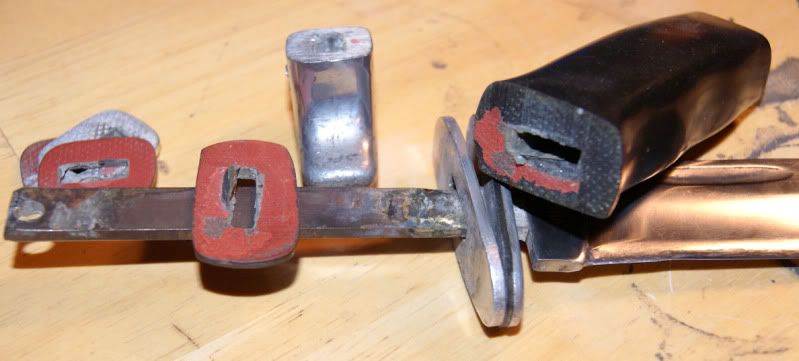

TAH has some pictures of the Buck 119 tang. It is pretty substantial. It is definitely larger than the tang on a Mora or a Buck Vanguard.
Those photos weren't mine and they have vanished - courtesy of Photobucket. Here's a photo from Buck's website that shows the width of the 119 tang.
Here's another...
20180306_072519.jpg from David Martin........above^.........
I had this photo posted as the subject went this direction. I have not seen a half tang among Buck knives but I have them on some of our kitchen knives. DM
those full tang rat tail style...buck seems to radius the 90 where it goes to the tang and through the guard so that makes it quite strong and takes away the stress points.
thanks for sharing the pic/diagram with ole blue with us David. always appreciated.
oldee o
What's strange is that some tangs have a radius...
and some don't... :confused:
interesting. wasnt aware of that. older or newer or can be both? thank you Sir.
hard to tell in the pictures but there is a small radius (in the .02" range) on all of the tangs we do. nothing huge like the top photo. It is possible that older blades do not have it.
