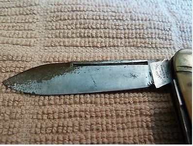

Pretty sure that it is not gassing and the blade patina was either forced or from regular use. Many times the gassing will cause the blades to rust and there will be a distinct line down the blades where the blades are protected somewhat from the handles. The celluloid looks bright and clean on yours. My only caution would be storing it in a box away from all other knives. I never buy them though, although many are very pretty.
IMO it's not off gassing. The dark "patina" that happens on an off gassing knife happens above (outside) the handle.
It happens quite quickly at times and usually includes pitting. Yours looks in very great condition, no shrinkage at the bolsters and a nice clean surface. Here is an extreme affect on the blade. If you google "celluloid gassing Oregon knife club" Theres a good article on the subject.
