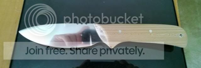

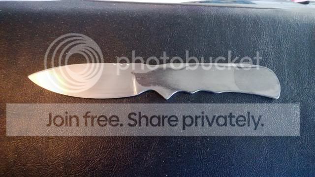

I cut this out the other day and got it hand filed, sanded and ready for HT.
Anything I should change? It's 1/8" 1080 with a 3.75" blade and 4.25" handle.
imo you should get rid of the rear finger choils (to the right of the maing "guard in the picture") so you can comfortably use an upside down grip edge facing up instead of down so as to drag through the hide. other than that small thing it looks great
To me it's not really a skinner, but one of many good shapes for a hunting knife. I too, believe you should remove the two finger choils. They don't allow for finger movement. I don't know why you want to drag a knife through the hide. It's always much easier to remove by always trying to cut from the inside rather than the outside through all the hair. Frank
Sorry its kinda hard to explain it you put the knife into the pelvic area skin and kneel next to the deer or stand over it and tilt the knife so the forward most point is the tip (inside the deer) and pull the knife forward to the ribcage. Just how I do it
i would ditch the 2 smaller finger grooves, round off the big one a little, and make the front choil a bit deeper/more round so you can actually get a finger in it without pinching or having it feel like it's being pushed up onto the blade. I would also lengthen the finger rest on top of the blade a bit more forward so it ends just before the jimping starts. That will give 2 solid reference points for different grips.
from the picture, it looks like you may have a swedge -- not sure if you want that for skinning.
you will also want to drill your rivet and lanyard holes before HT.
The proportions of the drop point and belly are well matched, as is blade length to handle.
Not that it can be done now, but I prefer a rising tip on my skinners. A blade that rises above the plane of the spine of the knife. It allows easier manipulation into smaller areas and tends to separate skin from hide a bit more cleanly. It doesn't seem to 'push' through the material... Due to that I would consider it a bit of a hunter.
I second (or third...) the loss of the finger grooves behind the guard and rounding of the finger choil. And absolutely drill any holes you may need prior to HT...
Thanks guys! I'll loose the two finger grooves and drill some holes before HT. I'll call this one a hunter and draw up a new design for a skinning knife.

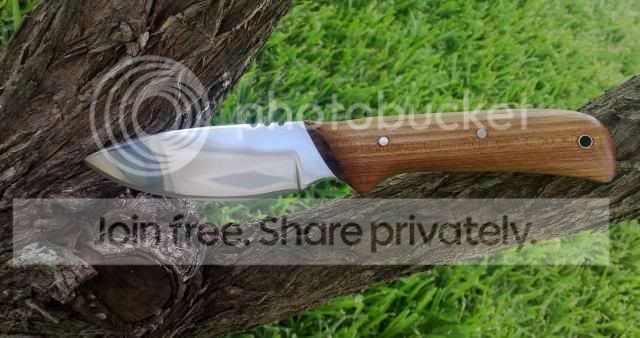

Well here it is after the recommended alterations, HT'ing and adding the handle -
Still have a few areas to touch up, but I think this is my best to date :D
Wow, loss of the finger grooves and opening the finger choil changed everything..
I like that the finger choil and area behing the finger guard arc up on the same angle and to the same depth into the knife. Its a very nice and balanced looking knife..
I like the simple and clean look and construction as well. Very nicely done.
Looks great! I'm not sure I like how the cutting edge stops at the bottom of the plunge and goes right into the choil. It gives it a clean line and all, but makes the last portion of the cutting edge almost unusable. Again, this is 100% personal preference, and I cannot really fault the blade in any way. Great job.

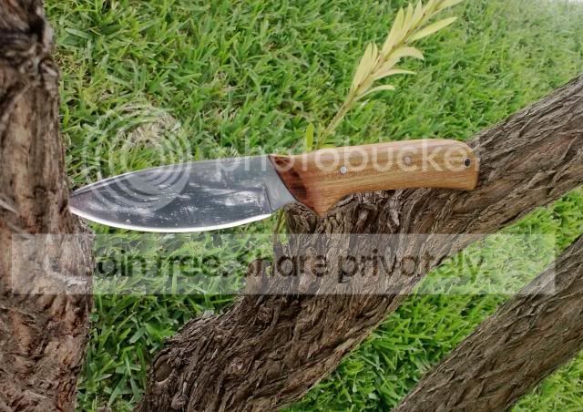

Got the edge put on and boiled linseed oil on the handle :)
I tried to get the grain to match up the best I could on the handle (red elm)
That is a beautiful knife brother. Very well executed, nice clean design... Great finish on the wood with nice straight grain layout, nice muted polish on the steel and nice tasteful file work as well. I wouldn't hesitate to add one to my collection.
