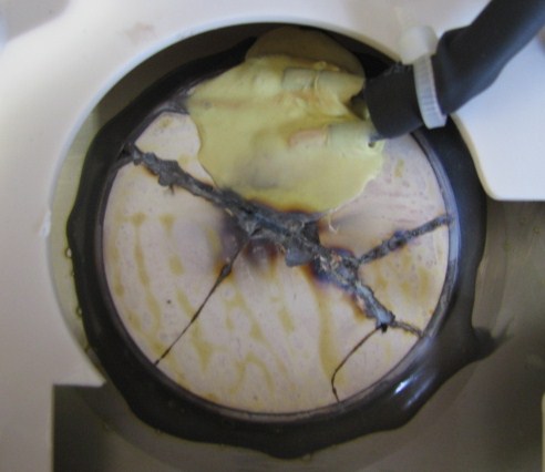

Instead of making a new topic I decided to bump this one.
I recently purchased the Harbor Freight Chicago Electric Ultrasonic and received it 7-10-09. My transducer thingamajig blew up 8-22-09. It smells like burning electrical inards too
It's been kinda hard looking for something else because mine looks just like the Sonic Wave, SharperTek, pretty much any brand 42,000hz for at home. Like a big ostrich egg. Are they the same on the inside electrically/mechanically?
I've been shopping for a while now and I'm more confused than ever.

I think most of the good ones use similar transducer tech to the broken harbor freight version you saw above, just better quality. Crest as far as I know is the only company putting their new industrial class transducer design into their new line of consumer units. You do definately want some kind of sweep frequency unit, this prevents uneven cleaning inside the tank caused by standing waves. Higher frequency units tend to clean better, if you get a quality machine don't worry about the wattage too much, it will be correct for the application. Really if I had to do this over again I wouldn't bother with any of those cheap units you mentioned, get a used Crest or something instead. You can get a new crest 275 (3/4 gallon) for around 250 bucks.
I believe they all use a Piezo Electric Transducer, but obviously of varying quality and coupling methods.
