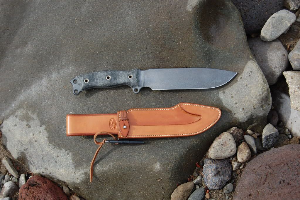

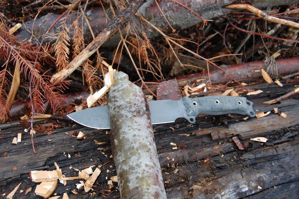

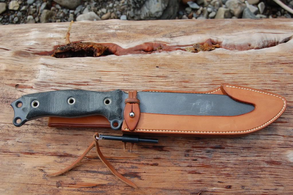

Here is a group shot of the three I like the best .....
