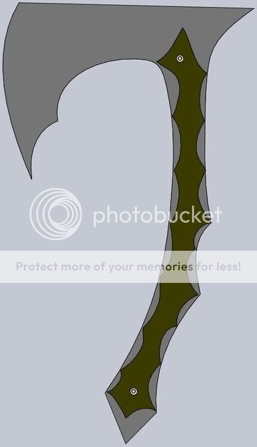

I'm thinking of building an axe, I was just curious about thoughts as to this silhouette. Material will be S7 with an integral "tang" for the haft, and G10 or Micarta scales and titanium bolts.
I'm interested in honest opinions, but be constructive please. Only in the first design stage. Not sure if I want to go with a removable modular headstock of go for economy and just mill an integral piece.
I think it looks really cool, but functionality wise, it would probably be better to remove those two prongs poking out of the back of the handle to allow for choking up on the handle. The odd shaped handle scales could be a bit uncomfortable too.
Cool design though, I love the shape of the head.
It technically is a longer handle, but this way really helped the balance of the thing, added to the weight so a little more kinetic energy and shifted the center of mass forward so you should have a little more controllable piece. The balance is about 2/3's up the spine towards the axe head and dead center, I had solidworks calculate it for me.
It looks cool, but the handle looks very uncomfortable, and to me the head looks a bit oversized, like a hatchet. but still, pretty darn cool.
I'd round the points on the back of the handle and maybe the one on the inner curve of the head. The last one just for looks. The flat across the top looks out of place, I'd do a curve of some sort across the top.
I'd make the point on the beard less acute or it might take care of itself, ie break off.
Also, what the others said: the scales look like they will make chopping a nightmare for the user.

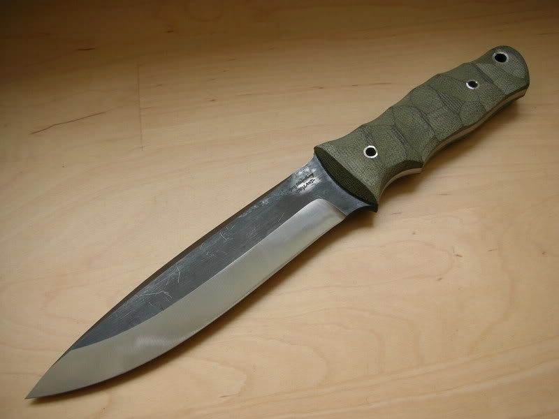

I think removing the scalloping from the back of the handle may work better, although I imagine you intended the grip to be either above or below them. It reminds me of the American Kami Bearded Camp Axe (about half way down the page).
http://www.americankami.com/axe.html

If it's a user, it's a horrible design from a usability perspective.
The scales are going to chew up your hands, the protruding tang is going to chew up your hands, and the center of mass will be shifted from the head down the handle a bit.
Is it a wood axe or a battle axe?
For a wood axe, other are right in that that sharp beard will probably break off in heavy use. If it's for cutting meat (battle axe) the beard won't be a problem, and will aid in hooking bones, limbs, weapons, etc.
Not sure the spike will be all that great. Maybe try something like an upside down American tanto. Think of a tanto shaped blade on the poll, with the spine toward the handle, and the angle and sharp end pointed up. By all means, go ahead and radius into the spike from below, although I'd make it a tighter radius to better enable choking up.
Aesthetically, I like the straight top, but I'd make the furthest point forward of the edge be the point where the top of the bit comes into the edge -- like a Viking great axe.
For the haft on a user, make it a continuous straight haft or curved, but get rid of the points, especially where the palms of the hands are going to be.
For the sake of balance, if you want to have metal the whole way down, at least have the tang flush with the micarta, better would be to use a hidden tang, bolt the micarta to it. This will mean less metal, shifting the center of mass more towards the head.
If this is more of a hang on the wall and look cool thing, then add all the points and scallops you want.

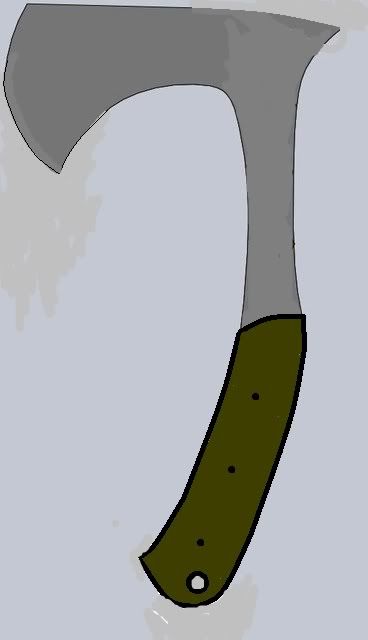

FriskyDingo: I hope you don't mind, I altered your picture to a more "practical" look than "tactical", so to speak. Here are my critiques. If I were making one, this is pretty much what I would to with it.
The blade is a bit too broad and "sweeping" for the handle size, and as said before it seems too thin and pointy to be durable around the point of the beard. IMO, and the scales/handle shaped like that would chew up your hands beyond belief. The pointy end at the handle could also cause some problems when chopping if you arent too careful. This is all just my opinion, I fully agree with the curved handle, if you get it balanced right, it looks wacky as all get out, but the head will hit EXACTLY where you want.
Let me know what you think.
Hope I could help a little, it'll still be pretty neat finished up how you have it drawn.

Looks like an American Kami design.
I don't care for either. They don't seem functional.
(although the American Kami looks sick...)

For practical everyday use as a tool, I appreciate the way you have provided a generous beard. For tasks choked up on the handle, like carving and whatnot, this lets you get your hand right behind the edge. I would suggest 3 things:
1. Move the scallops on the handle to the inside of the curve, and tone them down a little to serve as finger grooves. This will help you to know without looking where the axe is in you hand ( in, above, or below the grooves).
2. Mount solid scales right to the top of the helve.
3. Ease the wicked point you have on the bottom of the edge to make it less prone to snap off under stress.
