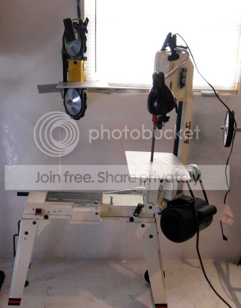

I use a Jet 4x6 horizontal/vertical (but I unly use it in vertical). A few mods to the stock table, and it's a pretty decent machine for the price... I think I paid about 230.00 for mine. I know a lot of guys use a porta-band too with good results. Whatever you end up with, I highly suggest the Lenox bi-metal blades.

There are a couple of threads on using a portable bandsaw. The bottom is the Harbor Freight. I mounted it on a wood stand and clamped to the bench. On sale these go for about $80.00. Get the warrenty and they will replace it free. Main issue is the plastice drive wheels. It does work well for roughing.
I find that a combination of the Jet 4x6 and the DeWalt portaband work best for me personally. Each has its own pros and cons.

I just bought the Dewalt portaband. I was gonna ask about special floating in air mount you had in the first picture, but I saw it mounted to the wall. Darn.
