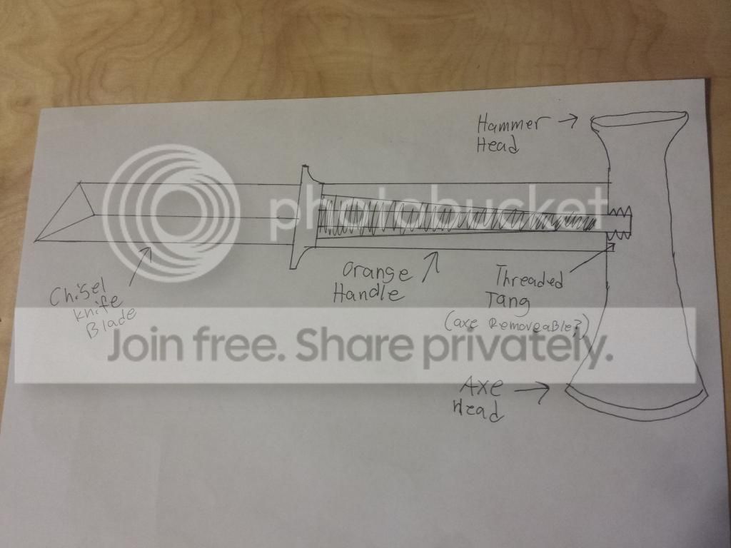

Any pics of the design?
BTW I was planning on a screw on pommel, I just wouldn't have a block long enough to span the length of the handle (think hatchet handle length with hatchet head/hammer head on pommel end with heavy duty chisel dive knife blade on the other. its mostly for digging around on a rocky bottom and widening the mouth of the lobster hole under the rock so its easier to get them out
OK a few things, this is in no way anything other than a concept drawing. this is what my dad drew out when I asked what he wanted, its simply a component drawing, the shapes, dimensions, and proportions are not accounted for.
that being said, he wants the handle long like a hatchet, he wants a thick chisel point blade (for prying) and some sort of hammer and Axe or rock hammer type head. I'm also going to throw a line cutter gut hook somewhere in there.
I know its crazy but he dives for lobster a lot and its what he wants, and honestly it looks quite challenging to pull off so I am looking forward to it for that reason.
Looking at the drawing, I would consider making the whole thing in one piece with a full tang flared for the guard. I think the threaded axe head will be problematic. It would be much stronger with g10 slabs using corby bolts. Jess

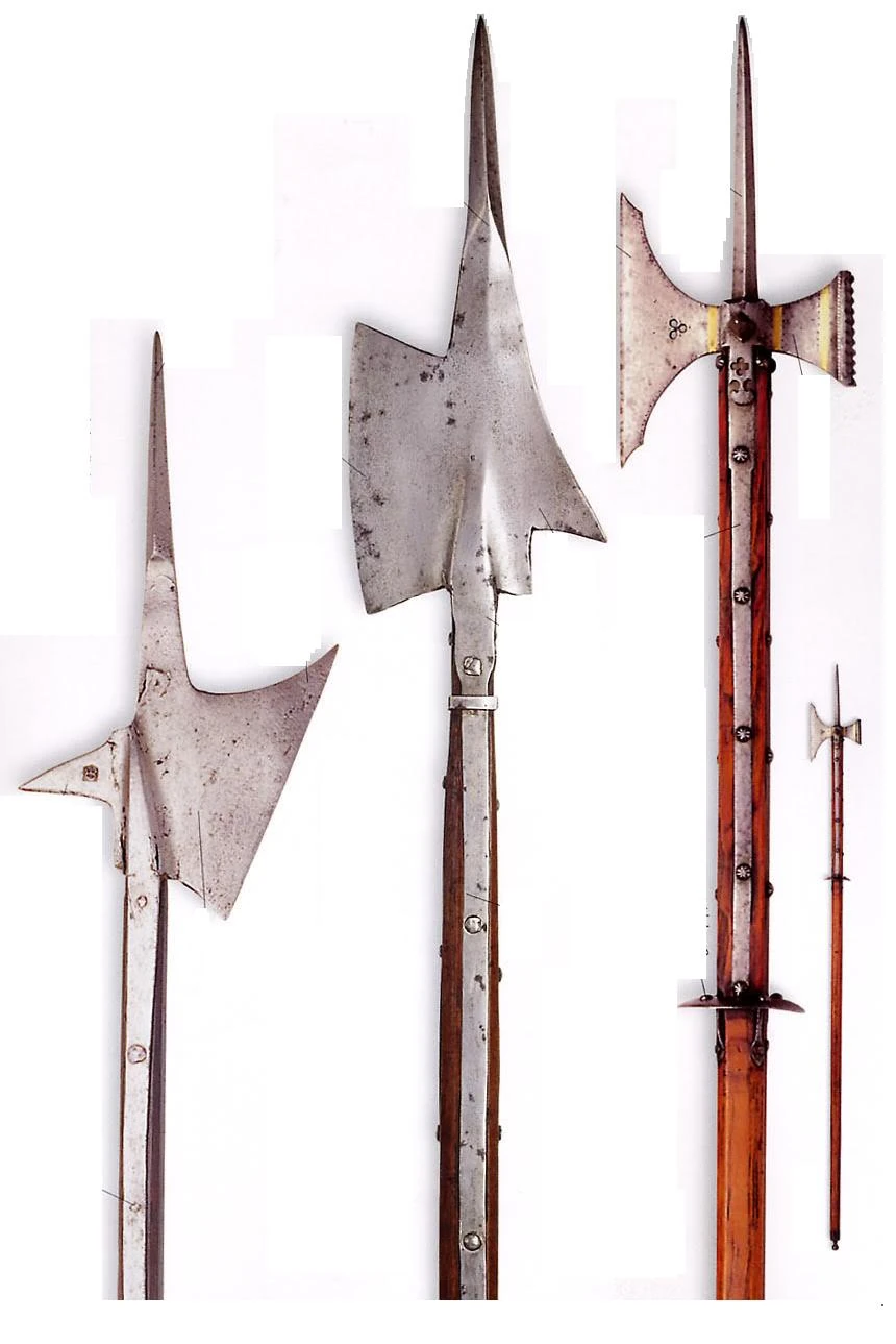

Check out acient halberds (the pole weapon)
They are basicaly what you are after, only on a long pole.
The hook can be replaced by a hammer head
I am looking at this as more of a hatchet with a sharpened pry bar at bottom of handle. I think sharp things on both ends of a tool is sort of dangerous but, for underwater use only maybe you do want two tools in one hand? I agree with Jesse above this would be nice as a full tang construction with bolted on slabs. Also consider this is an underwater hatchet, maybe shoot for the chisel portion to be removable/replaceable bolt on construction type thing.
In addition to wholeheartedly echoing everyone else's misgivings about the design, let me point out that you could simply use two blocks end to end, with a metal spacer in between to make it look more "intentional."

I'm not an idiot, the knife side will have a snap lock kydex sheath to prevent an accident, also this will be used underwater so its not like you can actually swing it.
I'm just creating the tool I was asked to make, I'm not really seeking design advice just information on how to use or locate g10 in this kind of length.
I think two blocks with a nickle silver spacer in the middle is the best idea, as I said above. thanks for the input.
I like the idea of a replaceable chisel, especially since he intends to pry with it. I was planning to make it really beefy to prevent breakage but I'm sure any thickness of hardened steel can still break if enough leverage is applied.
