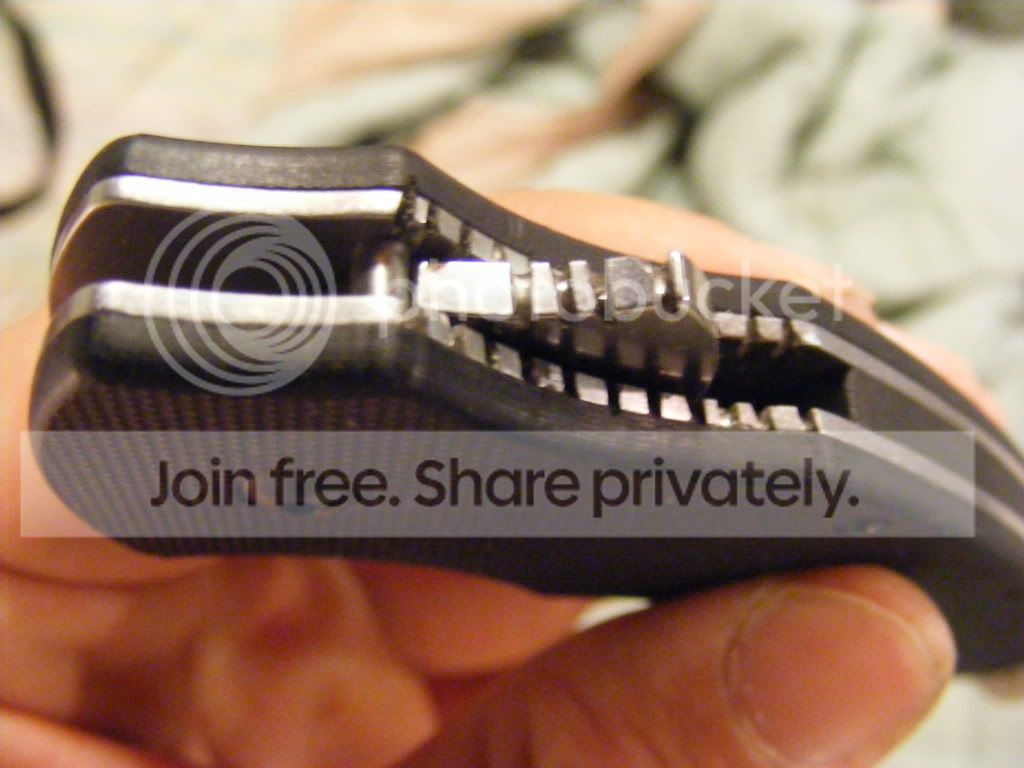

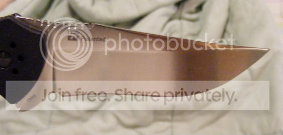

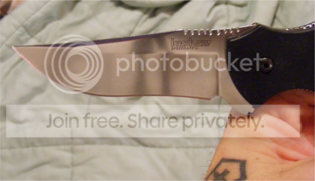

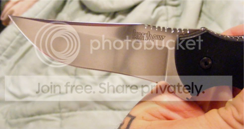

Here you go. This one just got done a few minutes ago. As far as shining the blade, all I did to this one was use simichrome polish. No sandpaper, emery, steel wool, etc. as my other Tremor was a little too shiny for me. The two vertical lines you see right before the Kershaw logo are reflections of the camera strap.

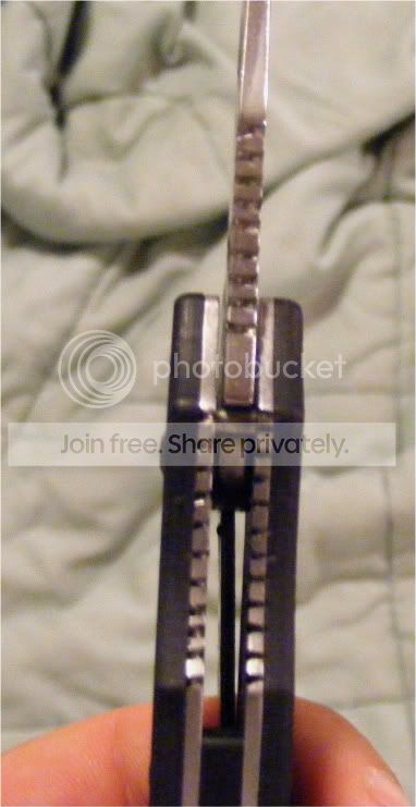

Also notice that I added jimping to the blade's spine and thumb ramp...
Also the flipper for a better grip on my index finger...

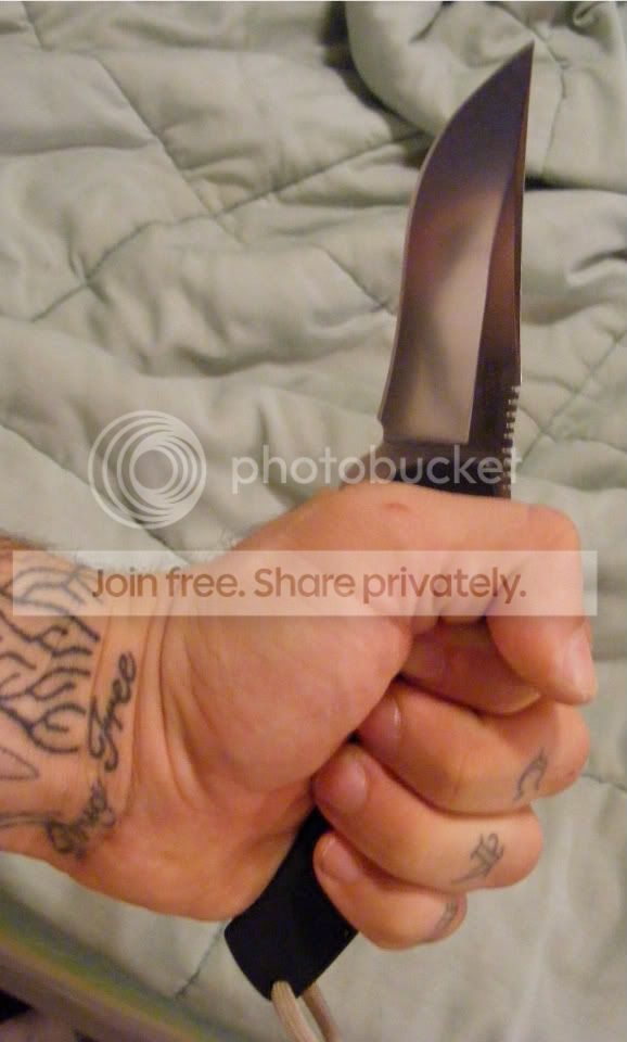

Also, the knife works well in a reverse (icepick) grip...

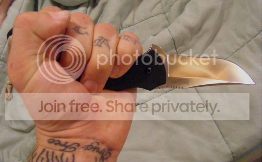

As well as an edge in hammer grip (pikal for me)...
