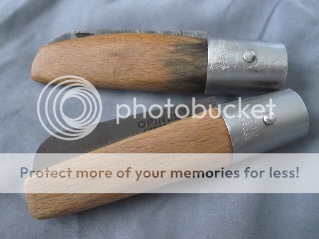

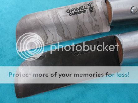

Here a couple of my modded Opis:
One with mustard tiger stripe patina (Dijon of course!) and the other with vinegar patina.
Blade Scout, those are VERY cool mods on your Opinel. They're like a small folding Santoku. Now I will have to mod one. Thanks. I discovered Opinel knives in 1975 when I took up backpacking and needed a light camp knife and have been a fan ever since. Opinel is one of the only examples of French engineering that I like.

Those look awesome! Are they hard to open?
They can be a bit stiff to open if the wood gets damp and swells - there's no liner in there.
Thank you very much.
I made them, as I wanted some effective box cutters and they certainly perform fine. They will absolutely shred a cardboard box in no time flat.
I like the Santoku analogy, as that blade shape is a favorite design of mine. Opinel makes a fine fixed Santoku BTW.
Here are some of my Opis in an earlier incarnation;

Mine are not hard to open, but as others have mentioned, some Opinels can become hard to open, when/if the wood swells.
I've since given my Opis plenty of wood oil and they havent warped (yet).

I prefer to work on the number 12 and cut them down to size with a Dremel.
I also put the nail nick in one of them with the Dremel at an angle - very easy to do and if I can do it, anybody can do it.
When cutting the blade, just take care not to damage the temper.
When sanding the wooden handle, one also has to take care not to take off too much on the back/spine part of the handle, as you risk sanding off too much material and go through the wood when shaping it.

How exactly did you get that patina? I'm refering to the lighter striped one. They almost look like flames. Very cool!
