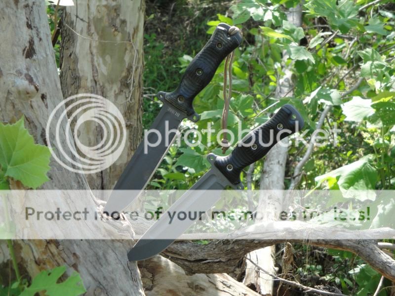

Here is my tanker grey with black g10
and here is a black canvas tanker grey original team gemini that I sold.
and here they are together
