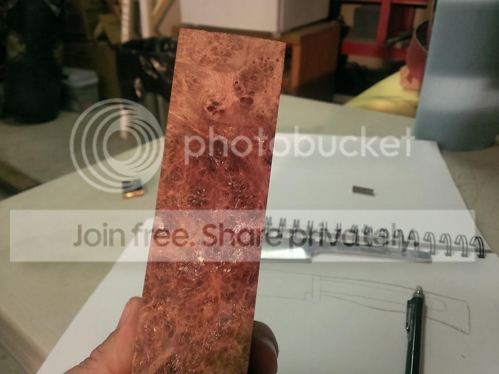

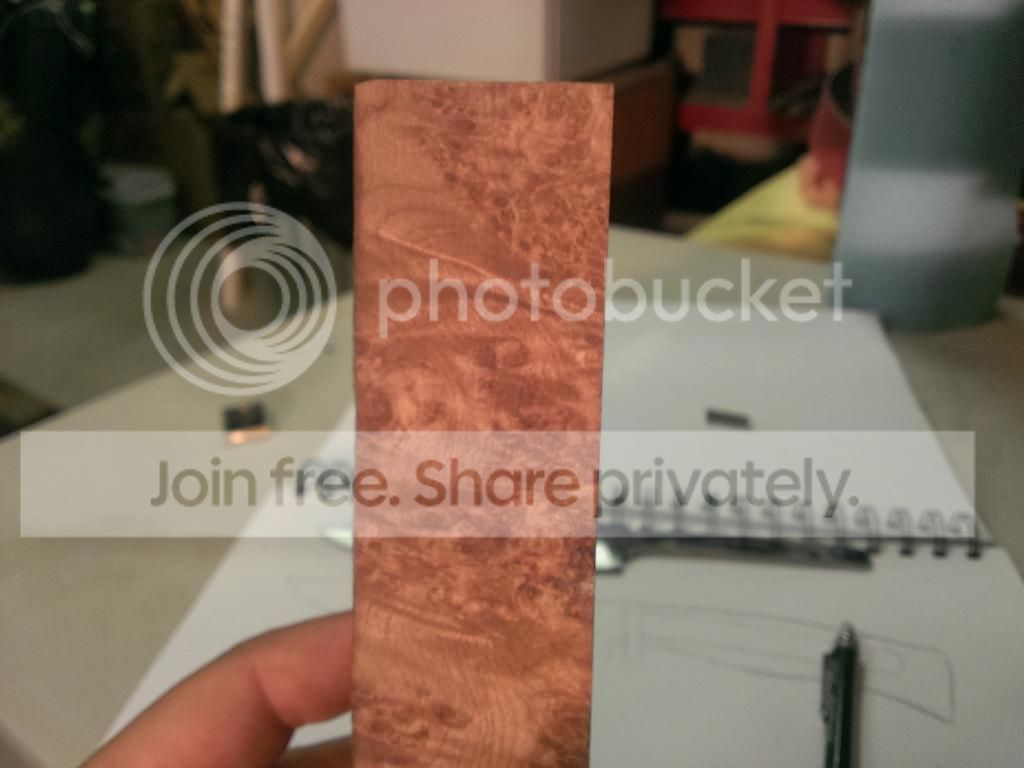

I got a piece of stabilized maple burl, but I've ever worked with burl wood before. I can identify long grain (picture 1) on two parallel sides, but the other two sides don't have it (picture 2).
Is there a specific way I should orient the block for strength or looks?
hi,
since the block is stabilized, strength should be ok...
regarding look it is up to you to decide which side is better, but may consider two things:
1: the burl is irregular in figures, so when you shape the handle you may dig into different figures/orientations from what originally appeared on the surface.
2: anyway the "display" side of the knife/handle is the left one (edge down-tip to the left)
Nice burl, congratulations :)
Stefano
Depending on the orientation, the finished look will change.
To determine orientation, grind the block ( or at least an inch of one end) in a more of less round shape. This will let you see the best orientation. I usually set the eyes on the sides. After the curves are added to the handle, this makes a really nice display. Occasionally, when there are few or very small eyes, or when there is curl, I place the quilt/curl pattern on the sides. This will allow the most chatoyancy to show up most boldly.
I orient the eyes on the side and am pleased if I am able to end up with a pattern like this on the top and bottom. Jess
