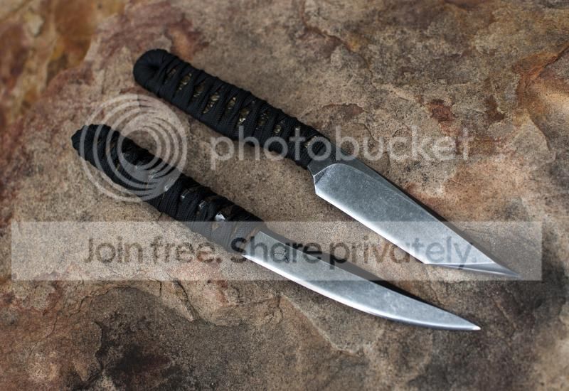

Thanks alot guys. That is really helpful stuff. I recently made a kwaiken and I made a menuki with some scrap Ti that I had. I gave it a hammered finish and anodized it. I will keep my eye out for items I can use for Menuki.

Thanks. Here is a picture of the kwaiken with my Menuki. The other kwaiken has rattlesnake underlay and I didn't want to cover it with a menuki, so it went without.
