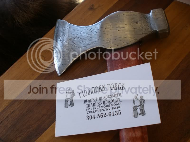

Not very good light out today. Notice the hatchet which is 3 is a lot golder cause it's older. The sheath knife is only 1yr.
With the covers on
Normally never use this unless backpacking but since I had it out I thought I'd chop up this oak log somebody dragged to the fire ring last time we had a party.

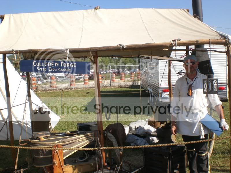

Charley is a super friendly guy and I regret I haven't hung out more at his shop. He sets up every year at the Pumpkin Festival in Milton where they have a reenactor type camp and sells stuff. That's where I first met him.
Here's some pics of his festival forge and some of his stuff.
Cable damascus hatchet
Rasp Bowie

Some of his other stuff
Fire ring with swivel grate
The portable forge
