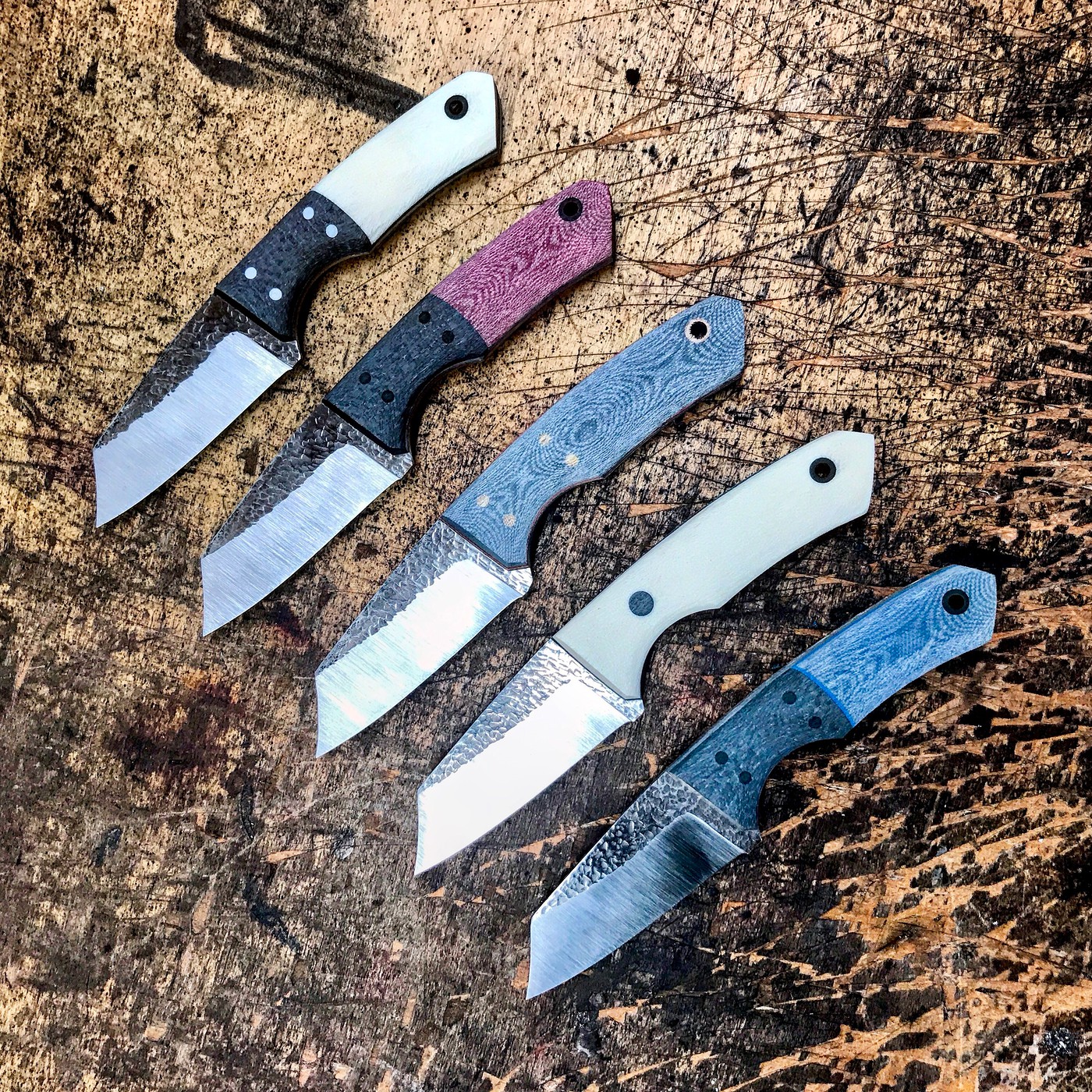

Not sure what these are going to end up as, but they need some blue and I need one..... :D
I have not decided the handles I will put on them yet, Blue is a very good possibility though!

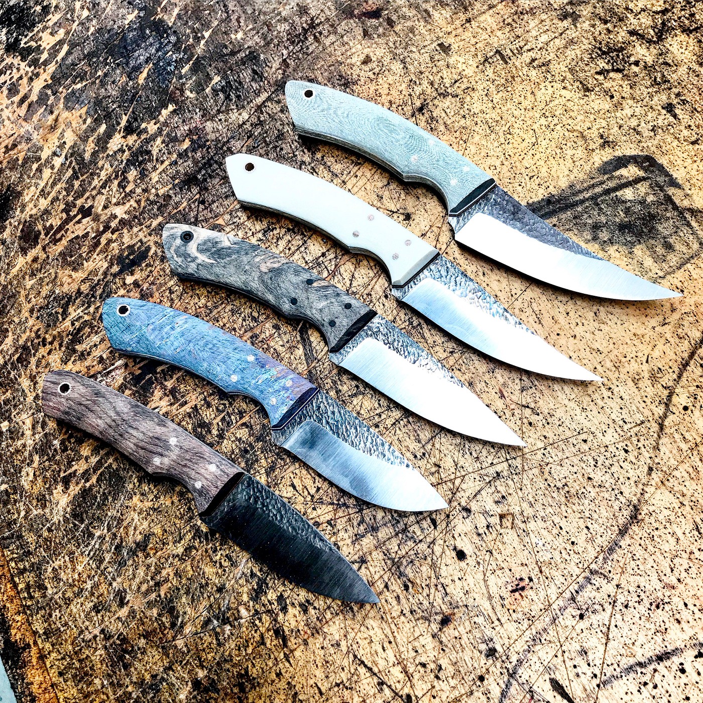

At this stage I have used an 80 grit belt and removed any of the remaining steel I need to to maintain my blade geometry, next I will progress from 120 grit to a rough A100 prior to glue up, that way all I have to do when I done with the handle is pass the knife over the A100 belt a few times to get a nice even finish and remove any scratches or scuff that occurred during the handle shaping or finishing process

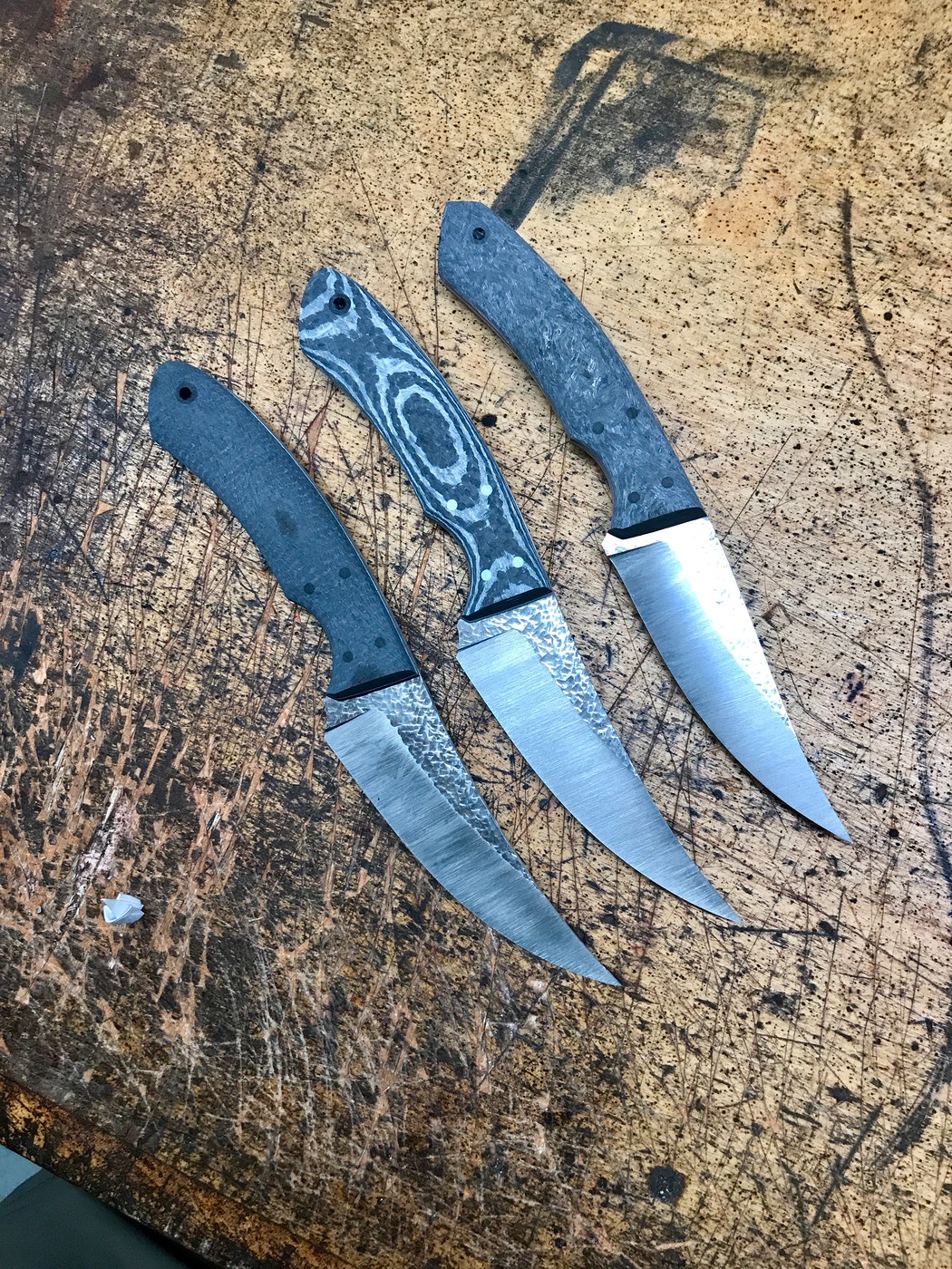

The Chef's knife is coming along nicely, it was a challenge to grind, even though it is .125" the Blade height allows for similar geometry to the main bevel as your 1/16'' Nomad,
I chose 1095 for a couple of reasons, it is relatively inexpensive to obtain in various sizes and work with, it is a simple alloy and makes an excellent chef knife, alot of the times when trying out new designs I am unfamiliar with I will revert back to a High Carbon steel. Once I get comfortable with a design I then move on to other steels, in this particular case, maybe some AEB-L, W2 or 3v in the future.

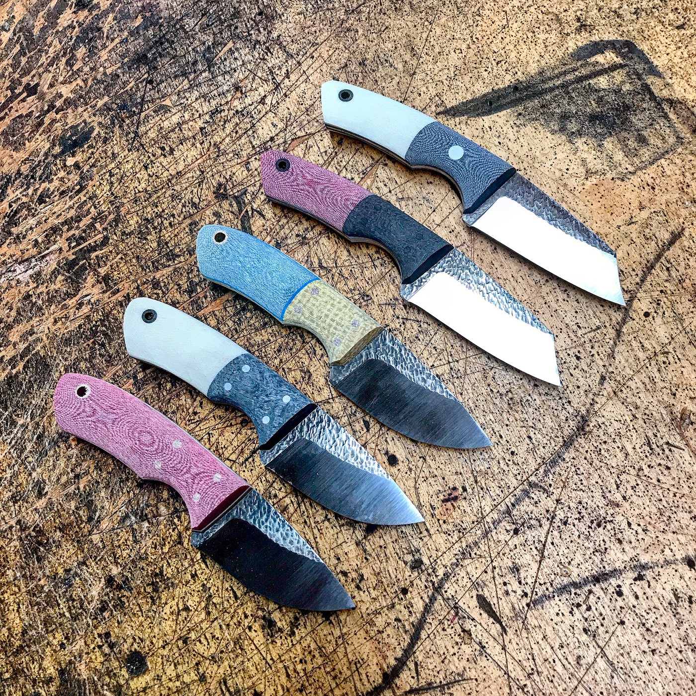

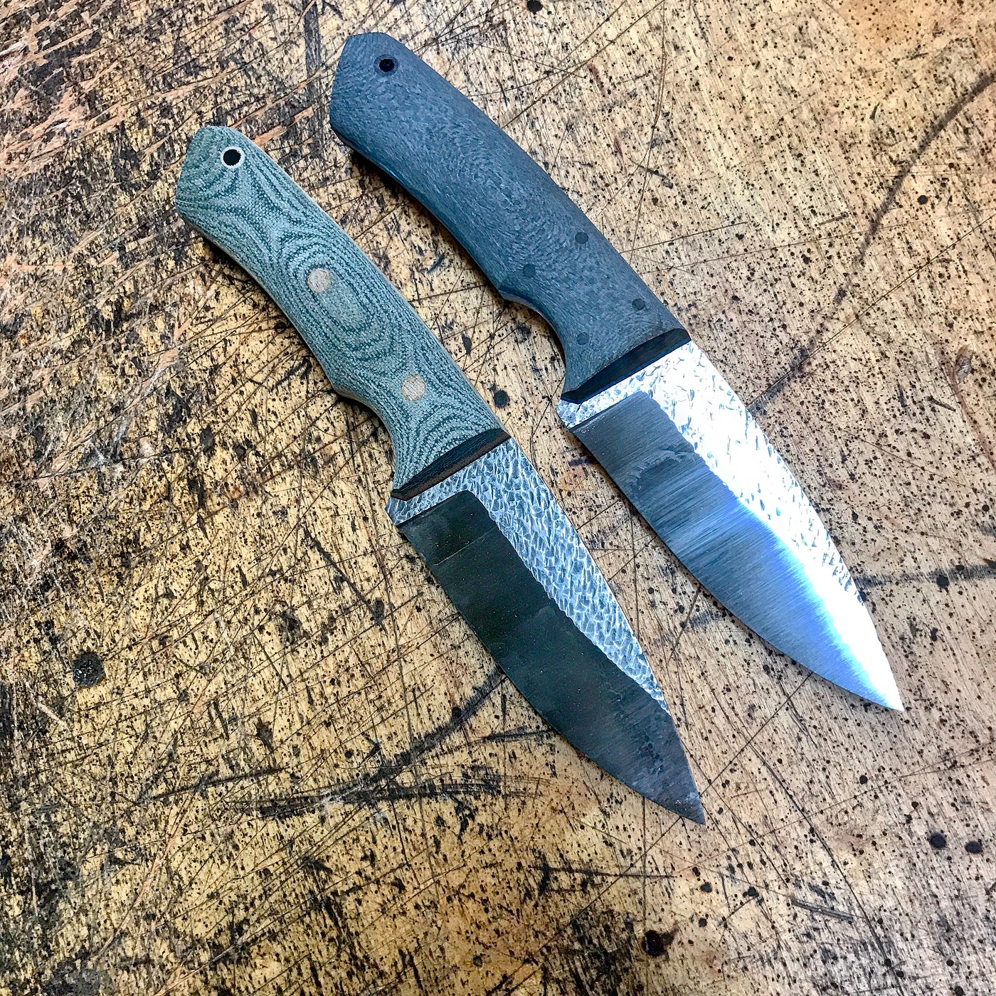

In the photographs I took Friday in total 55 are in the rough shape, fresh off the grinder, I hand filed these all weekend and started cleaning up the spines Sunday.
I will begin sanding these tonight and throughout the remainder of the week.
Hosted on Fotki
Closer Photos (These are still in rough shape)
These 13 are going to Fiddleback outpost for Blade Show.

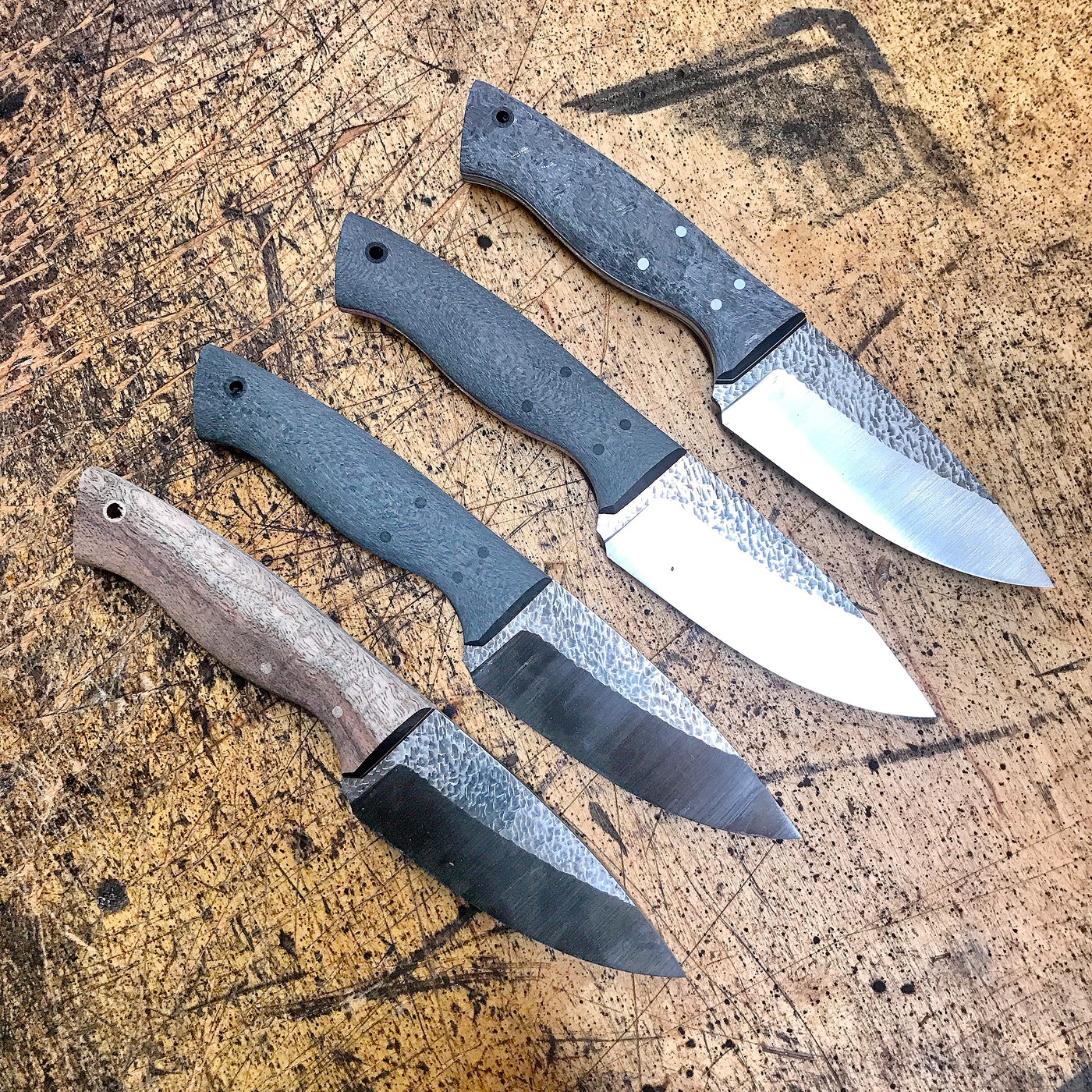

Blade Show Batch!
These 42 will be at my Table (4G)
