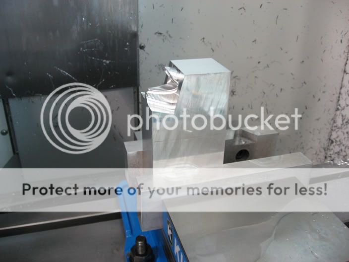

I live in Mooresville NC, probably the epicenter of racing in the US. This was a job for an odd camera mount to go on a race car. The car is an Indy style open wheel open cockpit type thing. The driver wanted the camera to be mounted up high and pointed down over his helmet so he could get a view of the cockpit, gauges, track and other cars. This put it up high into the wind. So it had to be stout, yet light weight and aerodynamic. We settled on a hollow airfoil design.

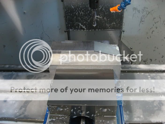

There is a hole and some other features at a weird angle so the first thing I did was cut a datum surface at that angle that I could fixture from. I'm using some used soft jaws here because I'll be cutting a fixture out of it later. The black line is a sharpie line - a reality check before starting.

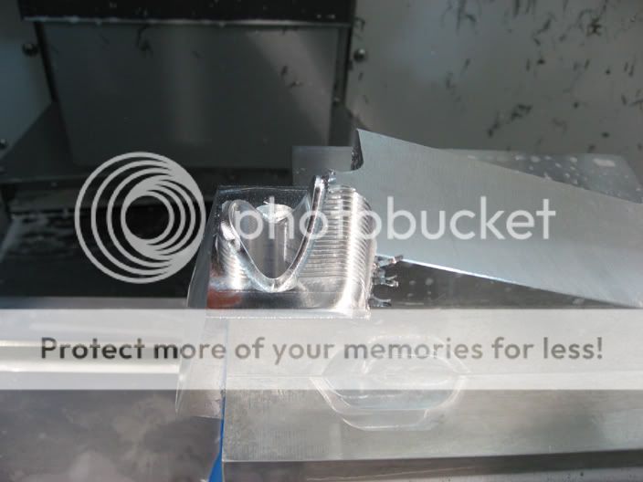

Using that surface to set my workpiece at an angle, I indicate off the edge and cut those features.

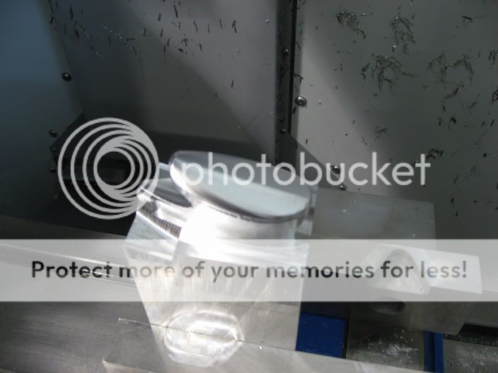

Then I set it upright
some more in process picts:

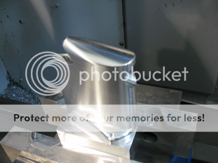

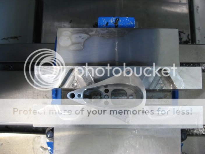

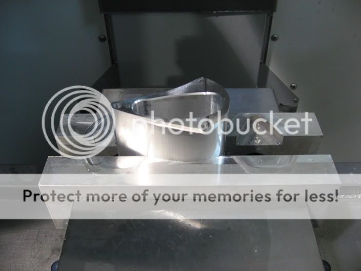

I then cut the soft jaws of the vice to hold the mount upside down. One of my challenges here was to make the mount conform to the geometry of the car, which was highly curved. I took measurements and determined the area was a constant radius side-to-side and parabolic like an airfoil in the direction of airflow. I printed out some templates of my best guess at these curves and a few iterations later I had templates that fit the car. I then combined these curves into 3D geometry I could machine onto a plastic prototype to test my fitup. A few tweaks to the prototype later I had good geometry. The area where the part is mounted had a few layers of paint but the mount crosses over the painted area and onto an area of unpainted carbon fiber, and surprisingly the thickness of the paint had to be taken into consideration to achieve a good fit. The paint was probably .010"!

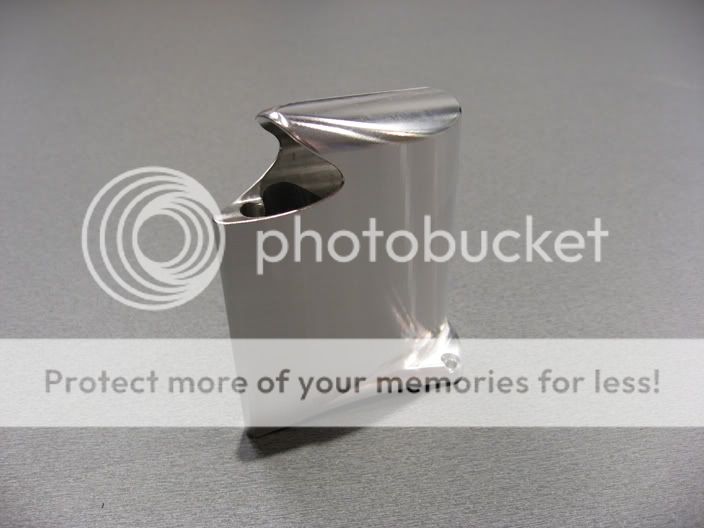

The mount was hollowed out until there was only a thin wall remaining. All the features cut from three directions intersect correctly and the trap door (not shown) works.
Finished shot

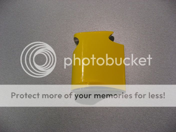

And after they painted it to match the car.

Here, this is kind of on topic (and more cool machining porn). I'm helping Tai make some of his heavy long nose forging hammers. This was the prototype:
But for "production" I'm turning the profile then milling it. Talk about a tough shape to hold in a vice. So I made these soft jaws to hold it for the milling. "Lord willing and the creek don't rise" I'll get some milled out this weekend. These will be heavy cuts in 4150 (on a much larger mill than the little Haas) so these are made of steel rather than aluminum, though I think aluminum would work if I were just making a couple.
