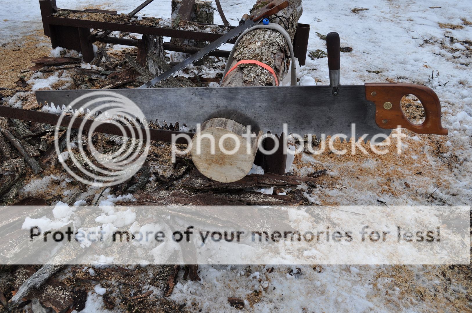

Henry Disston & Sons Perforated No. 514 Spring Steel. A perforated lance tooth design. 3.5 Ft.

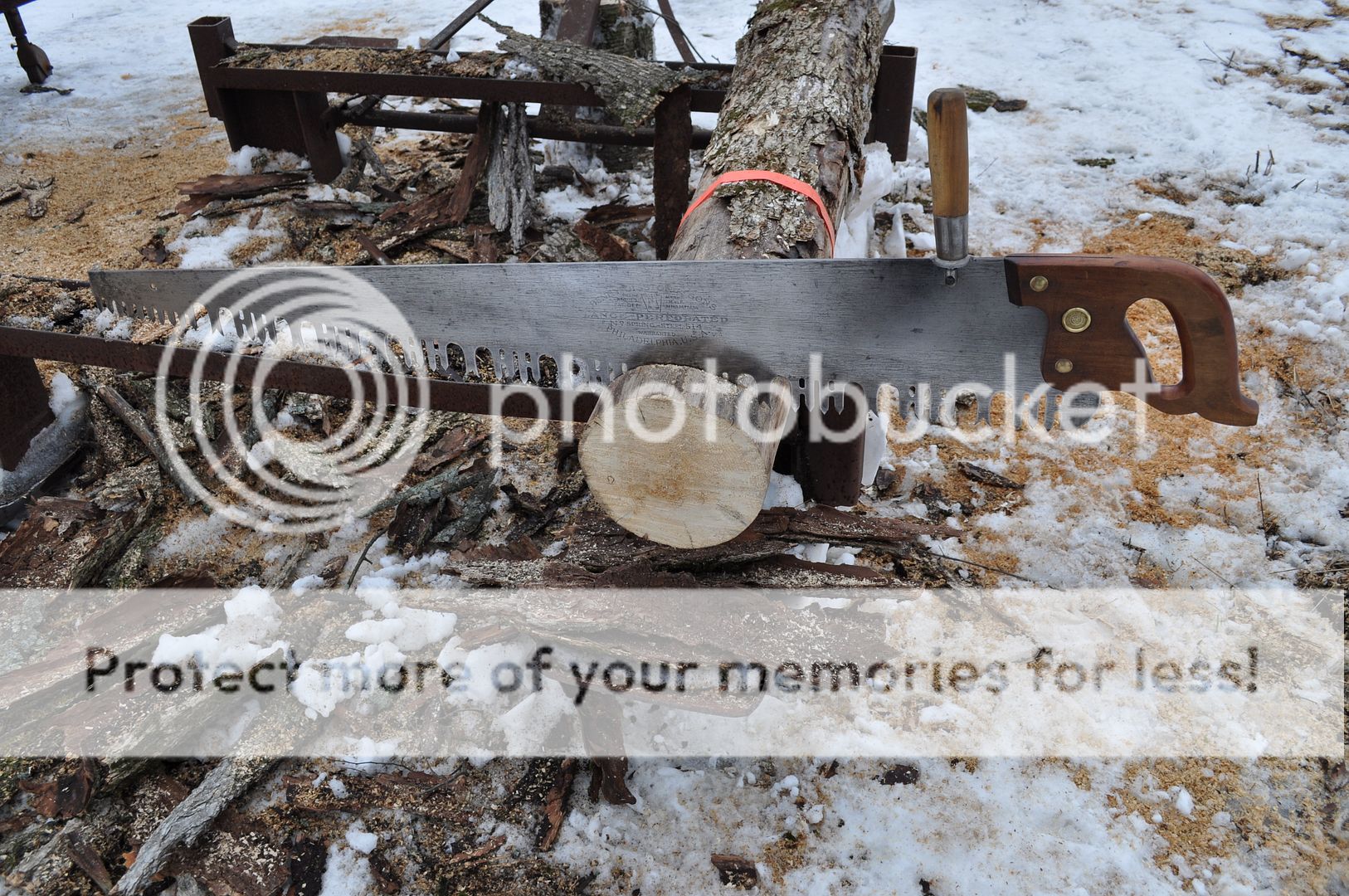

Disston Keystone K 954 Champion. A champion or tuttle tooth design. 3.5 Ft.
They are cutting through a dried bolt of elm. Elm is one of the toughest ugliest hardwoods I know of. Both saws cut easily through it. They really sang as they cut.

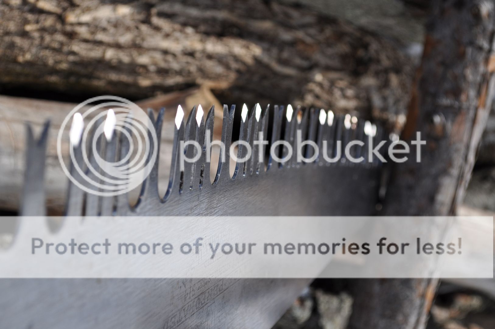

The lace tooth cutters gleam in the sun. They are very VERY sharp. A lance tooth saw is primarily used to cut softwoods. Treeline set this one up for softwoods.
The cutters on this champion tooth saw also gleam in the sun. They are very VERY sharp. A champion tooth saw is best used for hardwoods, but will work well in softwoods. Treeline set this one up primarily for hardwoods. The Y shaped teeth on both of these saws are called rakers. They have all been swedged to remove the wood from the kerf that the cutters make.
These are the first professionally tuned and sharpened crosscut saws that I have owned. They are a thrill to work with. No misery whips here as they cut beautifully. One doesn't get long shavings, noodles from a dry hardwood like elm. I'll need to find a green aspen or pine for that.
