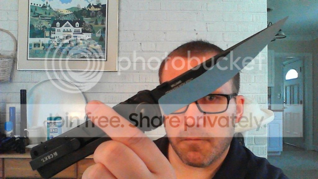

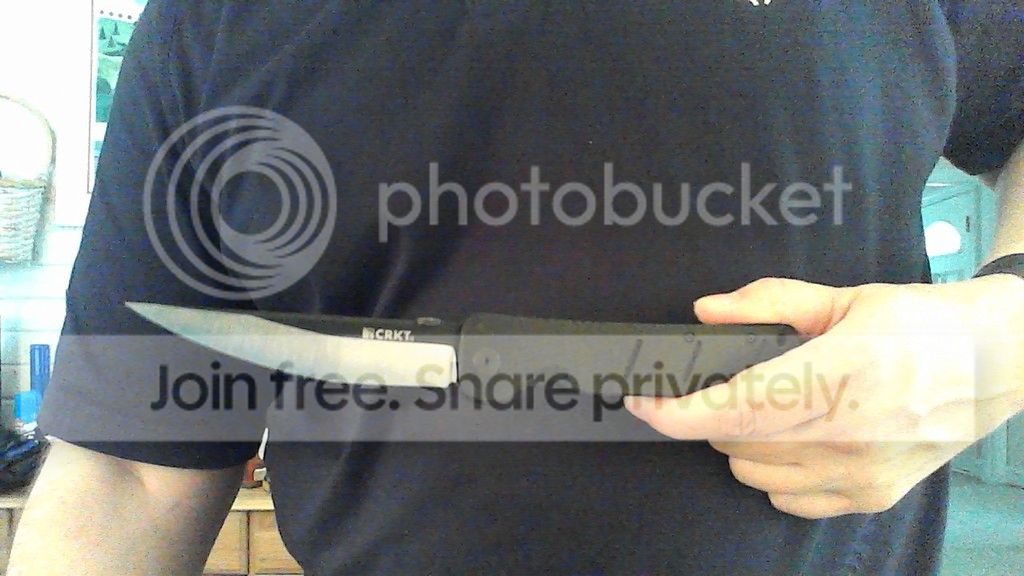

This is my Otanashi Noh Ken with regrind done by Josh at Razors Edge Knives. It is now so freaking sharp Im almost afraid to use it lol.

Nice CRKT, it's a light saber with that sharpness! :cool:

Yes this knife is part time self defense EDC the other self defense EDC I have is the Yojimbo 2. Depends on what I am wearing as to which one comes with me for the day. The Otanashi is now so freakishly sharp I find myself being very very careful with it even tightened up the pivot a bit to lessen the chance of it opening in my pocket. I am betting the knife would now penetrate kevlar its so sharp still with enough steel left to retain good tip strength. Josh also told me about not letting the knife get to hot during the grind so that was a relief. I have 10 knives currently being done by him for one thing or another have yet to be disappointed by RSK
