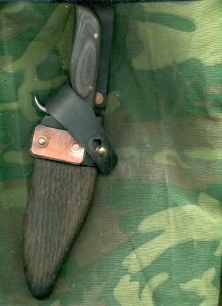

There's a great, cheap, natural black dye for leather that I use, dead vinager. Get some regular white vinager and put some steel shavings or steel wool (soap free) in it and let it sit, add more if needed. You can also use vinager you used to etch blades with before it died too. Once the vinager is dead (that preparation will probably take a few days), rub it onto the leather and dry with heat. Turns out like this...
P.S. It also works on some woods like the oak in the pic.
