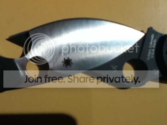

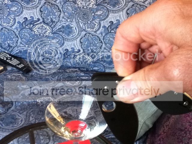

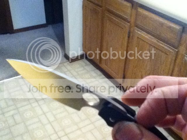

So . . . how sharp ? Out of the box edge clean; no wire edge AT ALL, no dings, no rolls, shave sharp(ish) / not hair whittling. Not particularly sharp but usable.

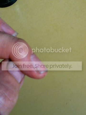

Well almost. I tried to nip off this bit of what ever attatched next to my finger nail. One of my tests for USABLE sharp. The edge wouldn’t do it without excess pressure. Cut into nail and left a line but really would not clip off the thing / would just go into it and stop.

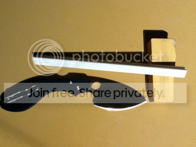

Buuuuusssssed out the Spyderco Ultra Fine rod. Got just a touch of a bur. Took off bur with the little hunk of Norton 8000 water stone. Getting to be some what hair whittling.
The edge easily cut through the finger nail thing.

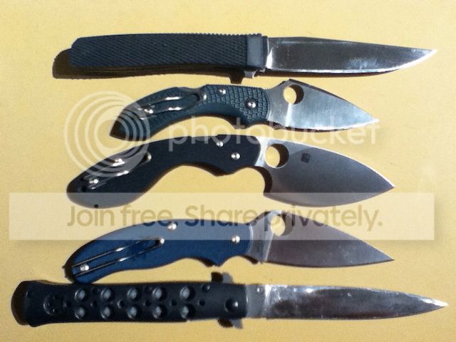

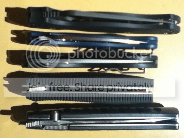

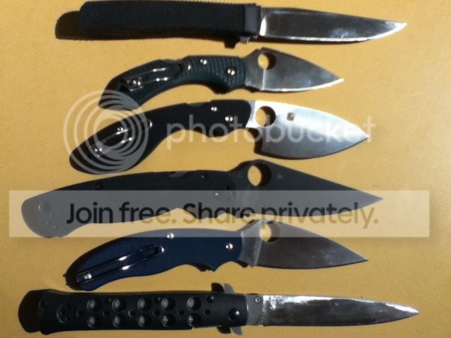

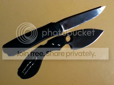

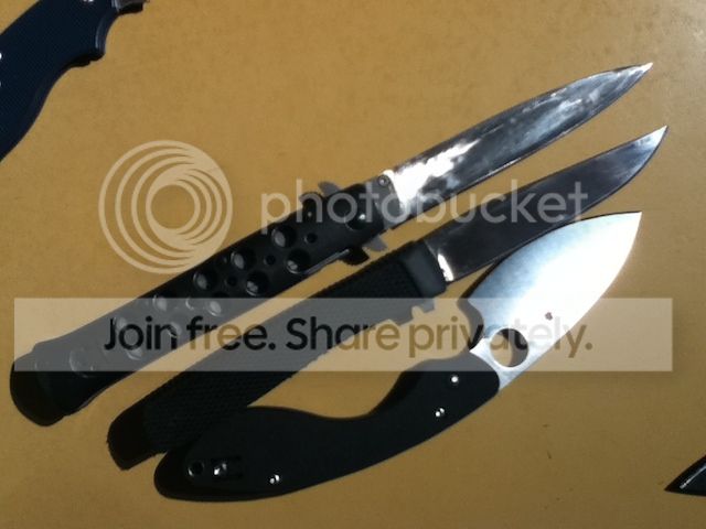

Some size comparison
Top knife is my Grail; Boker Urban Trapper rehandled.
Dragonfly
Ouroboros
UK PK
Cold Steel Ti Lite Four

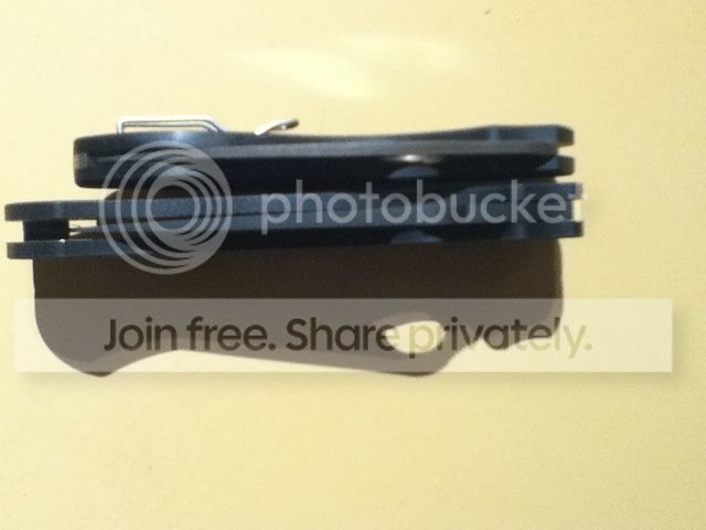

I liked that line up best as a photo but really we need a Para 2 in there so here it is
More length comparisons
Ouroboros with the Para 2
Ditto
Urban Trapper and Ouroboros

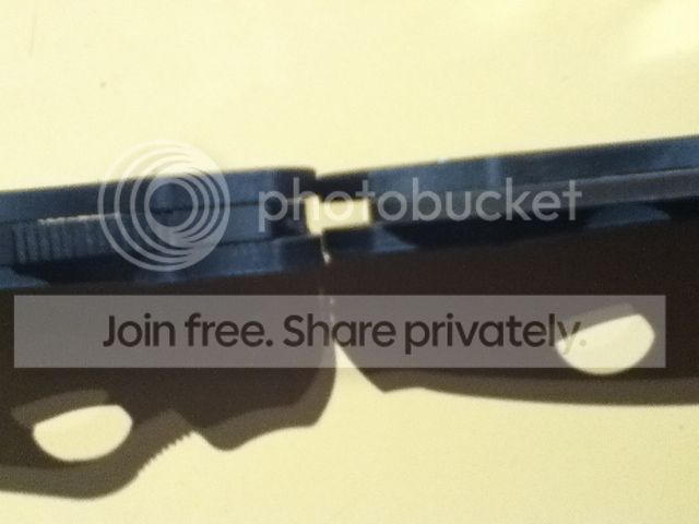

How’s the action ?
Soon after I got it I loosened the pivot probably one half of a revolution aprox. I did this in about six entsie increments while testing for play and ease of drop. This was done dry / no lube was added. Until later.
Out of the box, before and after adj. = quite usable and nice but no where near as free as the Para 2.
I added Starrett Instrument oil to the ball on the compression lock and to the pivot / white washers. Very sparingly.

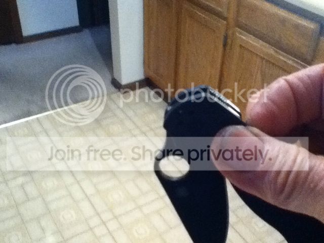

After the photo session I picked up the Ouroboros off the counter, held it with the blade about 45° or a bit more tip up and pressed the compression lock, pinched between thumb and index finger all the way to the scale. The blade did not drop.
Shake it and it will drop. Apply ever so light a touch with my other hand and it will drop.
There is a starting friction that must be over come. Even though there is a trace of play in the pivot.
Picked up the Para 2 and it dropped like it was falling out of an air plane with big rocks in it’s pockets.
Tried the Ouroboros again. Nope . . . same as the first try.
OK so the blade is way lighter and it can’t be expected to drop like the Para . . . right ? . . .

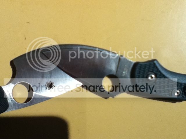

Here is the Dragonfly, dirty and some pocket lint. NEVER BEEN CLEANED JUST LUBED AND USED . . . drops . . . that little blade drops.
Whaaaaaaaahhhhhhh ?
One dif I noticed / looked for . . . the white washers in the Dragonfly are quite a bit larger in diameter than the ones in the Ouroboros . . . and obviously the Dragon is broken in but I never really did any intentional flipping or break in . . . it hasn’t been used all that much and I can’t recall a time when it wasn’t this free.

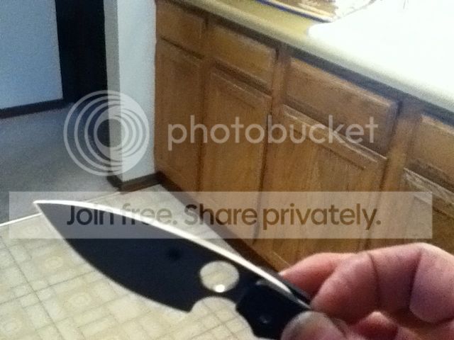

Update / some action shots.
Good enough letter opener. The first three of three were opened quite easily with the Ouroboros. For comparison the Urban Trapper struggles as a letter opener. Who knew.

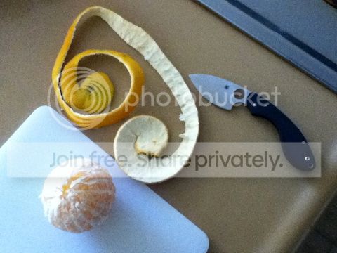

Orange peeler. I just scored through the skin and then peeled the orange by hand after I put the knife down. Felt really good and natural for the scoring though.

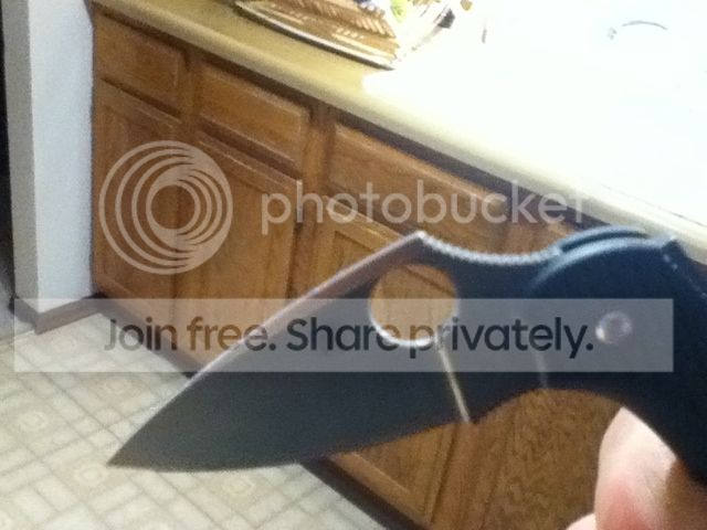

Here is a series of the closing technique I was attempting to describe. Works every time.
Hold knife with blade parallel to the floor, press lock with thumb and index and turn the knife over rotating wrist like turning a screw driver.

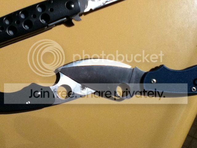

Every body wants it bigger . . .
Think of it as a gigantic Spyderco Dragonfly.
there . . . now it seems big . . . it's a BIG little knife.
Look at that big 'O edge compared to the Dragon
