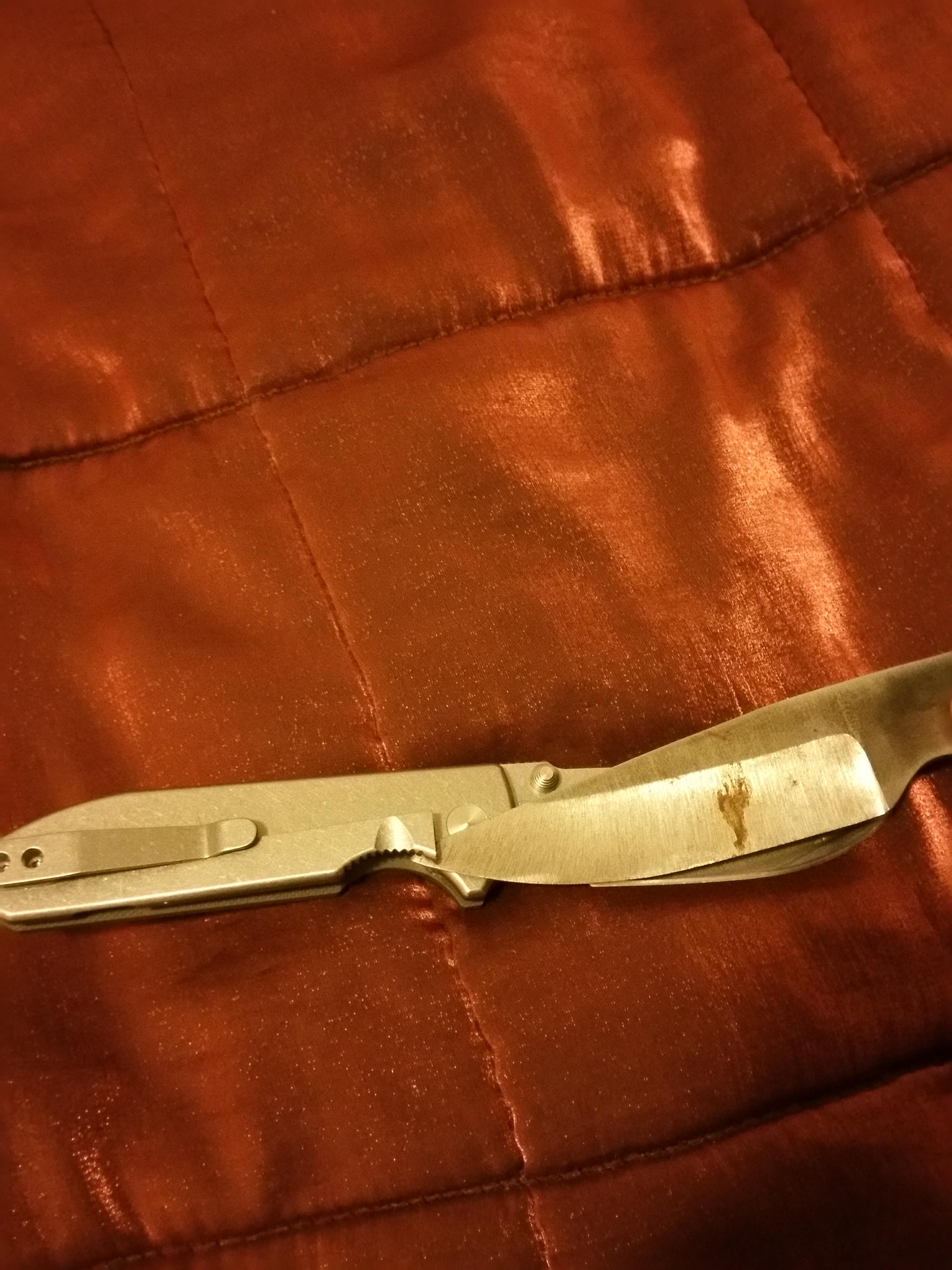

I decided to do a couple more tests, because I still think it would be impossible to break a lockbar because you disengaged it while under stress. My opinion does not apply to knives that are not correctly and proportionally built - Meaning extremely thin cutout or a lockup that is stuck to the point of having to use a tool to release it.
In this picture, I am using all my strength and forcing the lockbar out as far as I can with one hand, just like I would do if I was unlocking it. I measured the distance the lockbar travels - Measuring from flush - and I was able to move it 4.21mm past the frame.
http://imgur.com/lUD1DYi
I used a scrap knife I never finished to wedge between the frame and pry the lockbar much further than I could extend it. I measured it at 8.25mm. That's 4mm further than I could do it when putting as much force as possible while using the same technique I would be using if unlocking it. Next photo shows the knife back to normal, with no discernible differences. Feels to be the same amount of tension as there was before.
I know that each knife is different, and each person is different. Could it happen? Sure, but with a properly built knife, I doubt that it will ever happen. Like I said in an earlier, I moved it a lot further than I could one handed, and I didn't even begin to reverse the inward spring it already has, much less bend it so far that it breaks it. From my experience setting and fixing lockbars, someones thumb doesn't have enough travel in that grip to break it.

I would only interject to say that he proved it is a solution looking for a problem on well-built knives without any issue to stat with. When buying a knife blindly, or becoming subject to the rule that no two knives can be 100% the same in production, there certainly is a possibility that the issue could be real in some knives, and possibly in some particular instances of knives that are, as a whole, very well-made. There are issues in QC at some level or another for all knife manufacturers, even if those issues are very VERY minor in the case of CRK or similar quality products.
The simple version of what I'm trying to say is that this test proves 2 things in theory:
1. A well-built and executed knife will not likely need an over-travel stop for the lockbar.
2. The particular knives tested in both instances are (by this criteria) well-built and executed examples of those models.
That is not to say that absolutely every Sebenza is without the need for an over-travel stop given the same test were to be performed on each example (though I personally beliave that the Sebenza does NOT need one myself), or that all Dauntless models are completely without the need for one either (again, I believe it is a safe bet that they don't need one personally).
